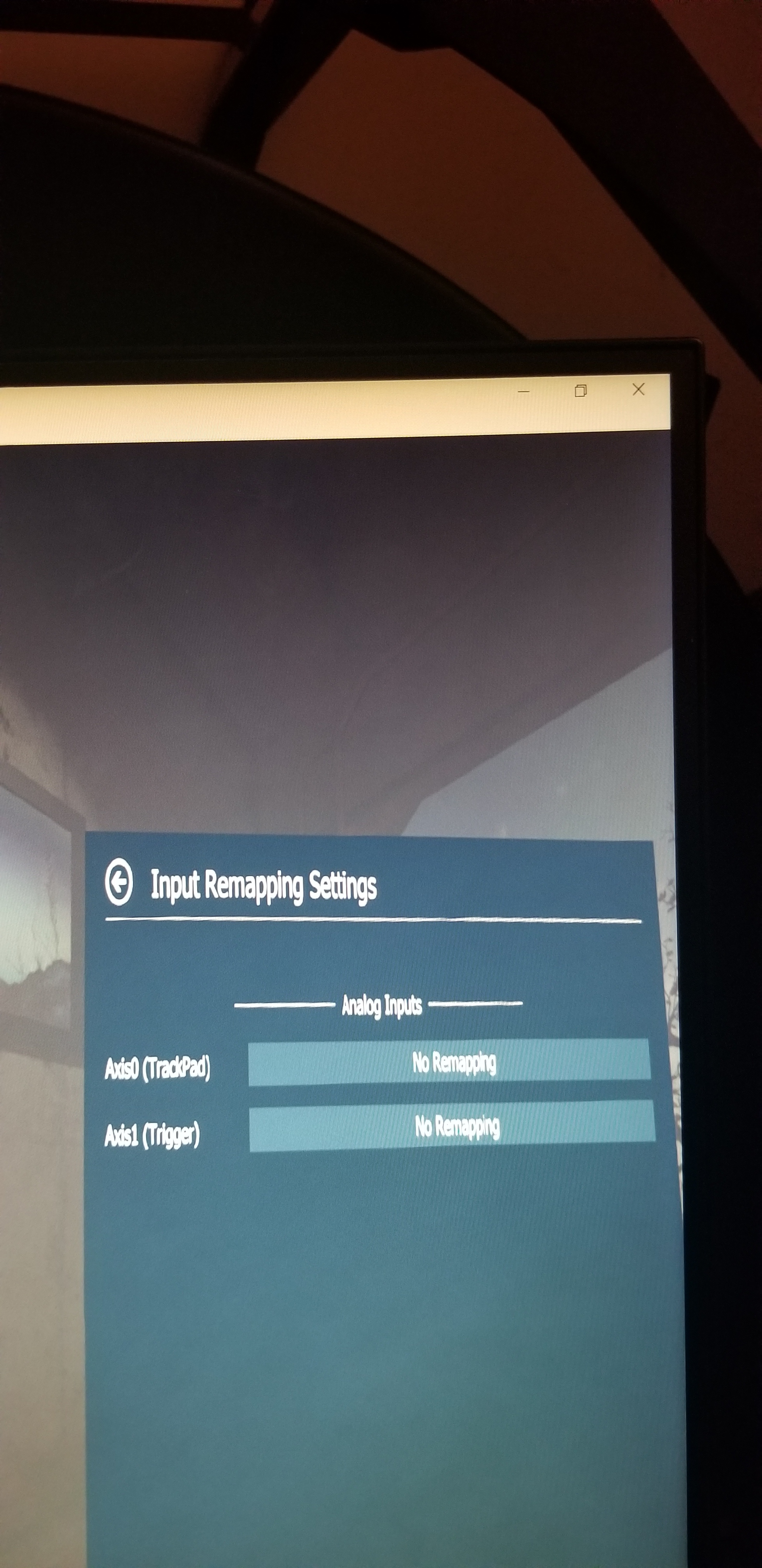

Do you guys know what version of steamvr was the last version working with openvr Input emulator , including all its functionality ?
I brought up the controller issue in the (NaLo)steam forums, and got a dll file to replace the default. SteamVR is no longer crashing when I have the controller connected.
As for the input emulator, I am using Sharkyh20’s fork, as this fixed the tracker/controller swap that stopped working.
Let us know how the captogloves work out.
Hi! Thank you so much for sharing the above solution for steamvr and input emulator.
I have quickly run it yesterday night and i saw that only the analog input can be remapped . There is no digital input remapping. I have never used input emulator before and I am not sure what is needed for remapping the clicks of the vive controllers to the captogloves.
Would you please be able to suggest what should I do?
Also, you mentioned some issues with the controller in nalo . What was that about ?
