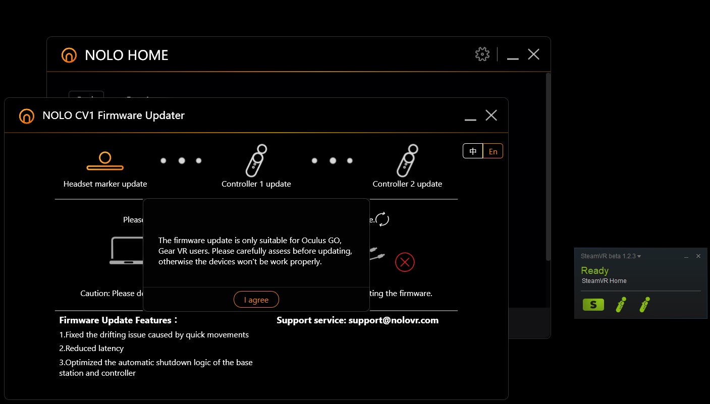

Latest Nolo HOME warns of firmware updates possibly messing up non-mobile VR HMD’s.
The focus has always been mobile 1st. (GearVR/Oculus Go, etc.)
Must find a way to downgrade firmware.

My Nolo is rarely used but wanted to see how it worked with he Oculus Go on the new NOLO HOME update.
After getting this warning, proceeding seemed risky:

And why are they writing “risky”? For me, it would be obvious if would be written “not compatible with non-mobile HMDs”.
