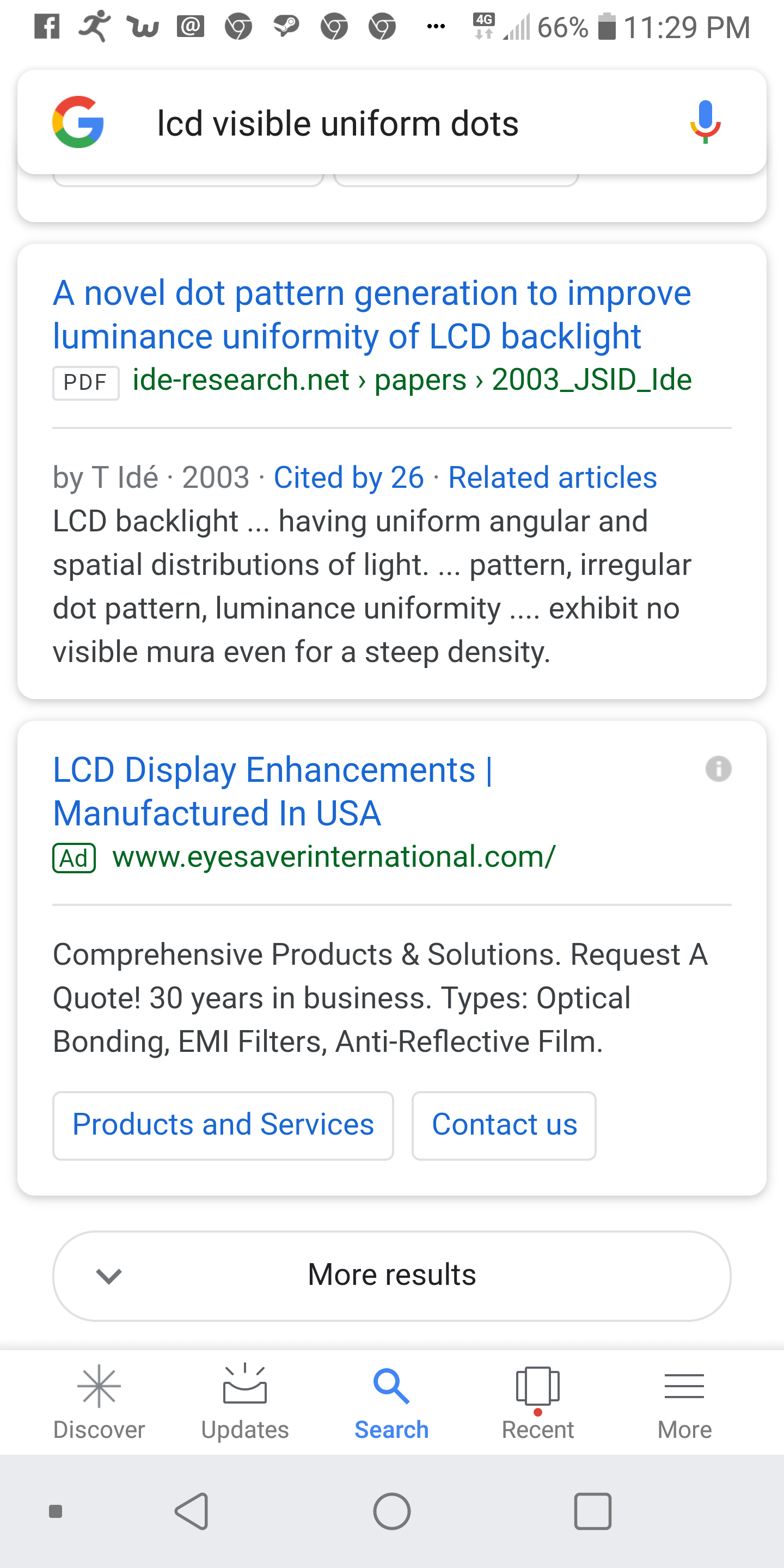

This might be an idea. Though tbh not a display tech expert but this suggests maybe help with backlight?
This won’t let me create a link
The Oculus Go apparently has them too. So maybe someone with it might know better. But from what I have read is a property of the panel & Robin gave the explanation to improve contrast. So maybe light dispersion. Or dots if fine enough might serve to enhance perceived color.

Yes I have just been looking around. The only screens I can find with dots are touch sense screens, and for you to not see the dots you need to look straight at the screen, If you look at the screen from an angel they apparently can be seen, and as the pimax screens are angled :thinking: :confused::wink::grinning:
