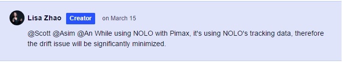

Isn’t there an option to disable the built-in gyro tracking in the Pimax? If there is then wouldn’t the Nolo do all the positioning and eliminate drift?
Of course , but piplay will not work that way.
Piplay will receive rotation data from pimax and position data from nolo.
Nolo has mentioned the possibility of solving the pimax drift problem.
Lisa Zhao said,
But who knows?
Our engineers are travelling from Pimax Shanghai office to Nolo office in Beijing to solve the tracking issue collaboratively. @PIMAX-Support please be aware of any new issue raised on the topic.
