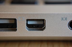

If the mDP port’s bandwitch limited to what is specified in 1.2, then you’ve found your bottleneck. I don’t believe there is any need for an active component.
Ithink when it comes to minidp it is1.2 for sure. there is no 1.4 minidp. my laptop is 1070 and minidp is 1.2. will buy a adapter to give it a try. But if your laptop have thunderblot3 you can try dp to thunderbolt3 adapter.

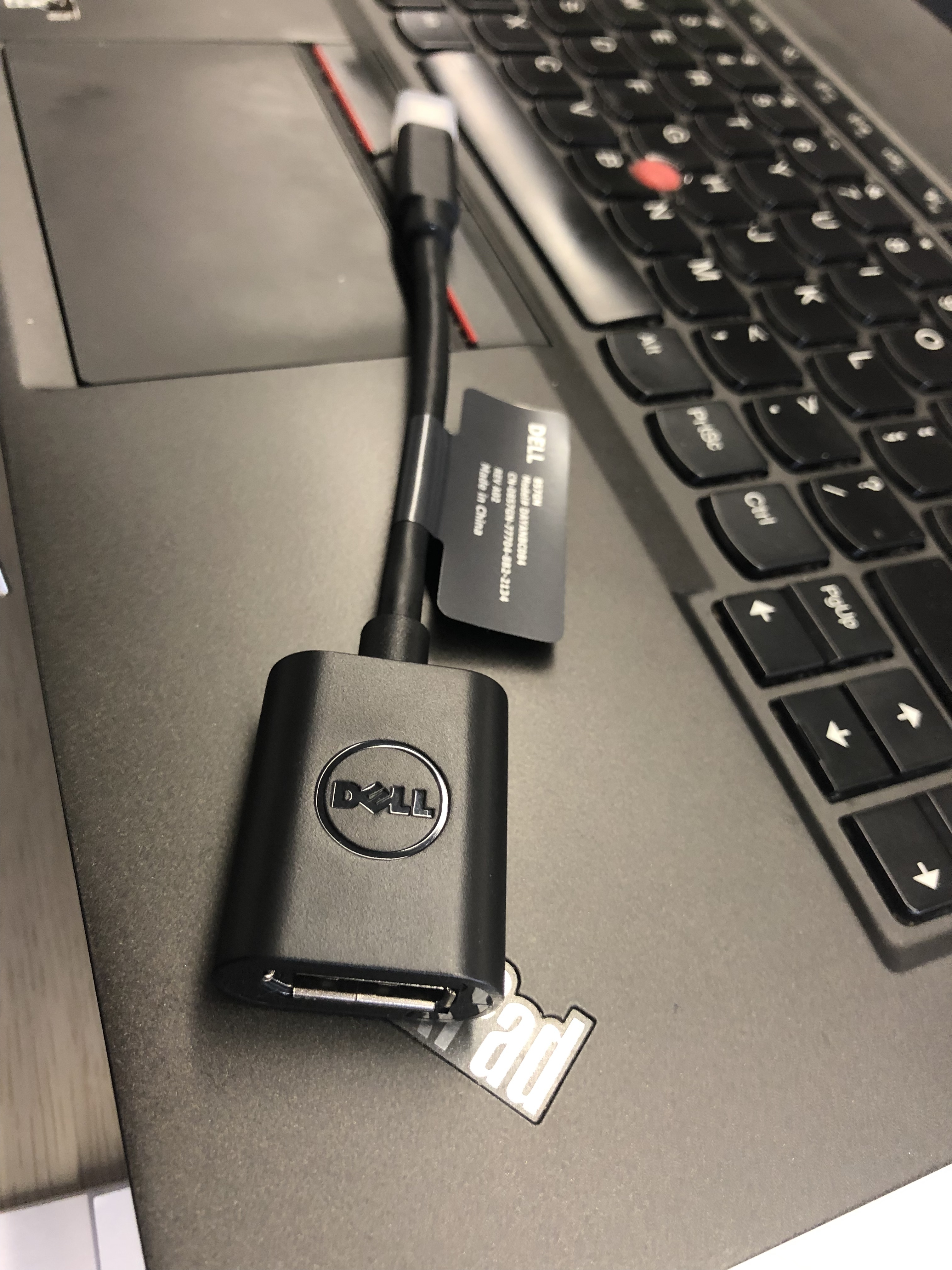

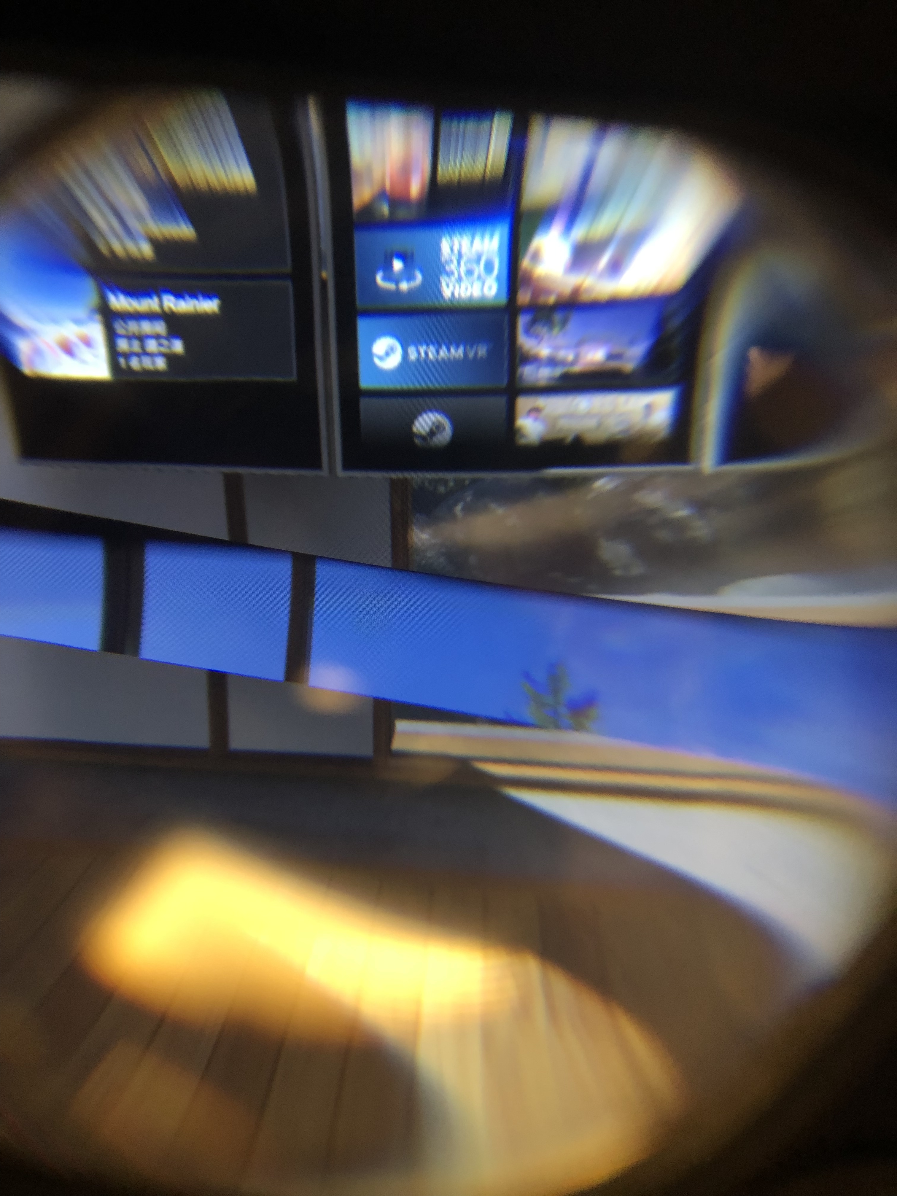

Did you try Mini DP?
@SweViver uses a cheap miniDP to DP adapter with his laptop with no issues:
