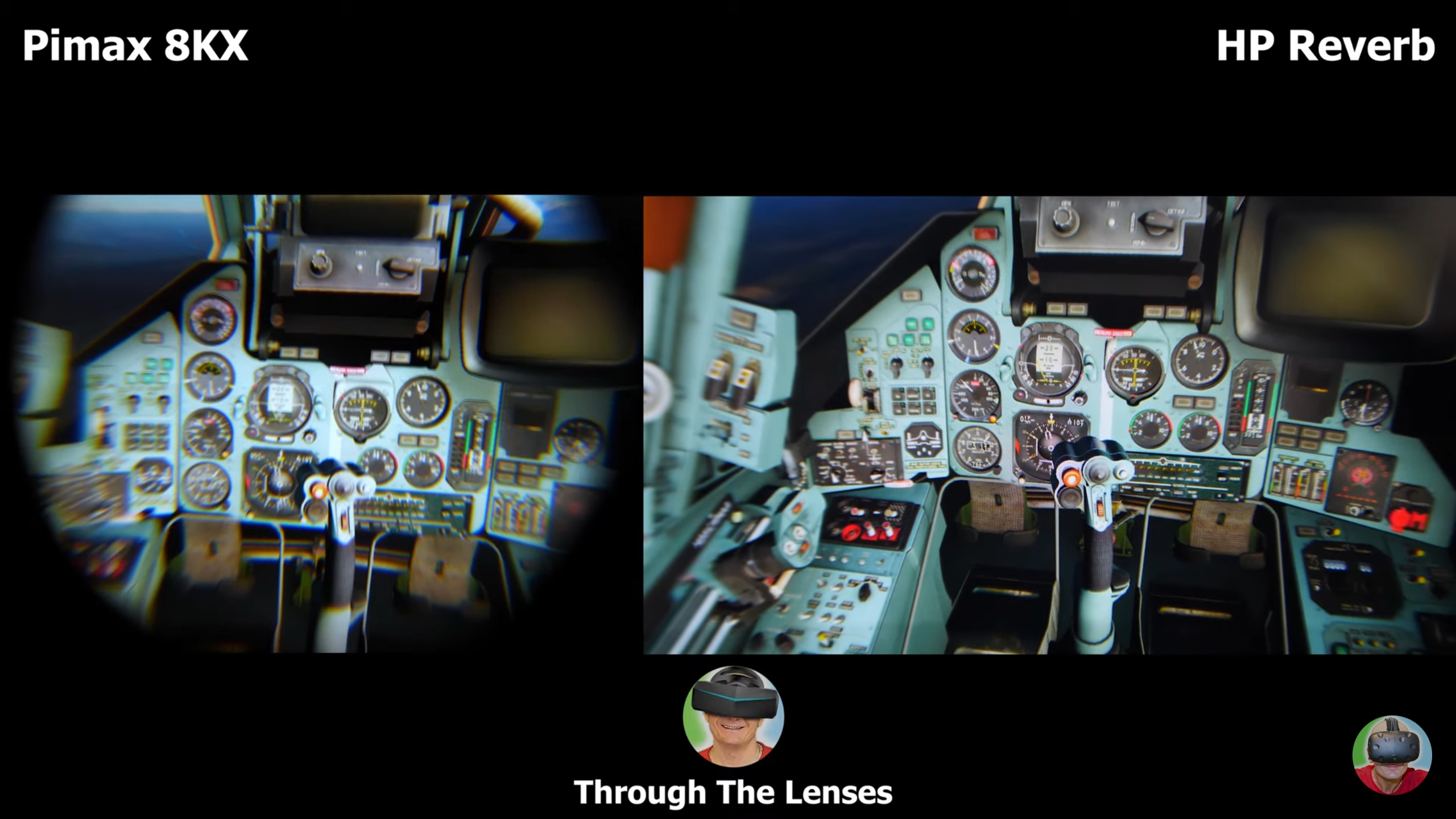

@SweViver
Thanks for your video Martin!
However you made a little mistake in 1:50 haha
As @jojon already explained the games usually calculate the SS factor per one dimension, while SteamVR calculates it per pixel count. Which is confusing especially if it is not stated anywhere.

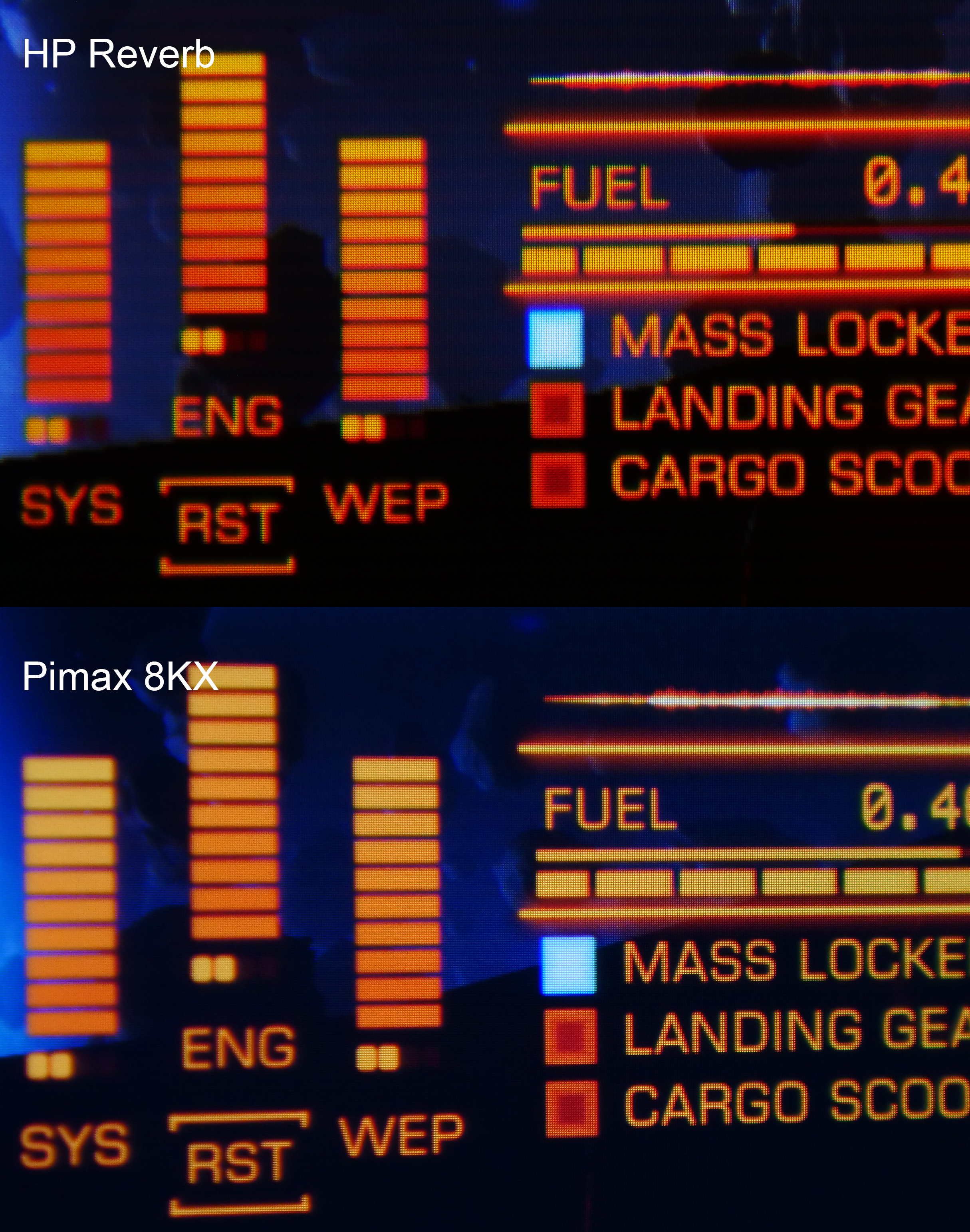

In case someone missed these macro shots (from the other thread):
Lydias left ear. See the subpixel alignment (horizontal vs vertical):
I think whats most impressive here is the upscaling of 8K+. Did not expect that.
is the 8KX upscaling as good ? ( yes thinking 1080ti )
