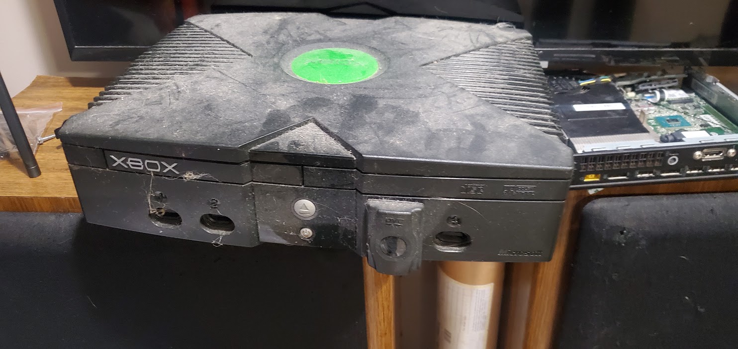

This does mean i had to kill my linux hypervisor and move it to this tho…
Say hello
to my “new” DB server, and file scanning server.
