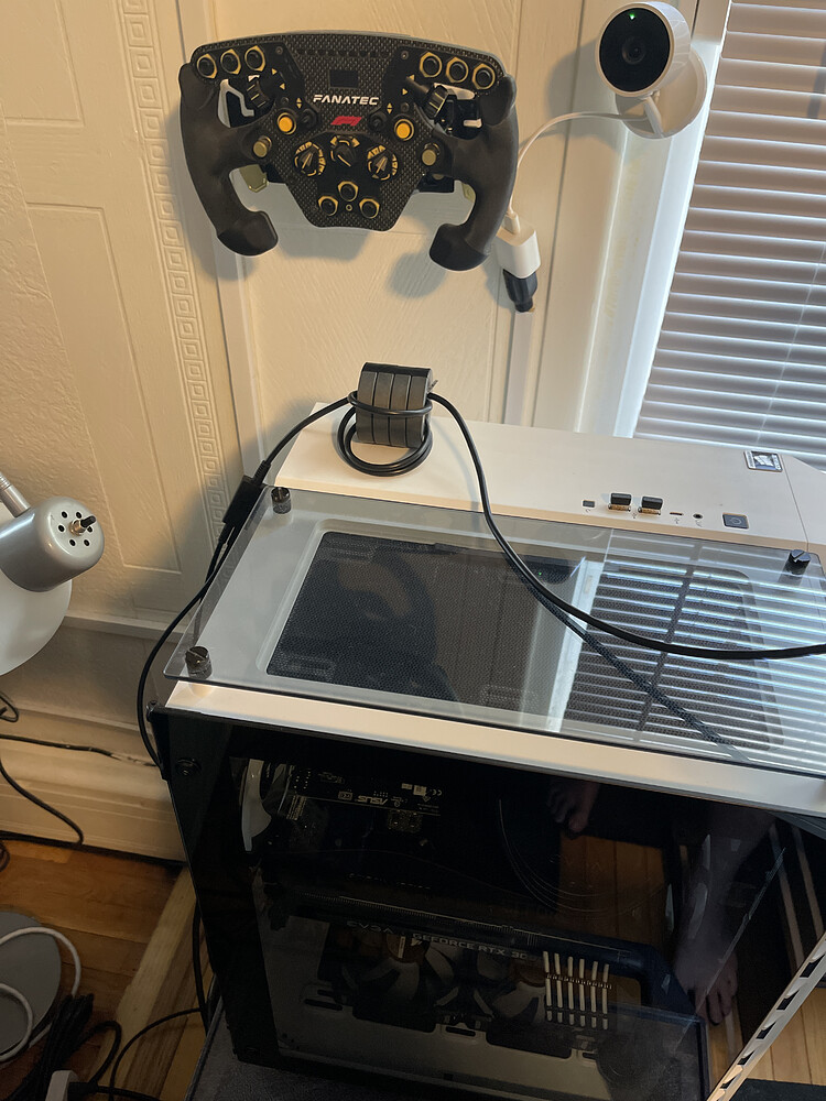

Some more testing today. 1.5+ hours without even a flash. I changed a few things
- Tried 75hz
- Unlooped the cable 1 time through the ferrite - so only 3 loops through the ferrites that i have
- Move the cable a bit further away from the PC’s POWER CABLE…
More and more and more testing to come lol - tomorrow the new optical cable is arriving.
Today I ran another 2+ hours without a hitch and had some more changes:
- Updated to the latest Win10 update
- wore a grounding bracelet
No flashes or blackouts again.
I also received the “ground loop shielded” optical cable. After some careful inspection between my old one and the one I was sent - they look identical like nothing was changed at all. The thickness of the cable is identical. Both have a closed loop reading on my multimeter (not sure what they were testing themselves but my original one doesn’t show O.L. and beeps with a reading on all 3 points)…
So I’ll test their cable, but I may have already found the causes… I’ll have to backtrack to see which one of the recent changes fixed the blackouts from happening… I suspect that the cable was too close to the PC’s Power cable and that caused interference though.

Yes i got 4 ferrites and looped thru only 2-3 times. Any more and i had issues but others said they use 4-6 loops through.
FT240-31 Ferrite Toroid Core is the type someone above recommended. I got mine from JPM Supply but you can find it elsewhere.

Ok so I received this new optical cable that they said is “ground loop shielded” - I didnt have much time in the morning to look at the differences but i noticed the diameter is exactly the same so i thought there must be no difference. I even quickly turned on the buzzer on the Multimeter that shows if there’s an open loop or a closed one (im not good at understanding this stuff), and thought it was the same until i just sat down and tested it again after what pimax told me.
Pimax reps said this after i asked them what the actual difference is in the new optical cable theyre having me test, and the old optical cables that has been out for a while. They said:
Update from hardware engineer, “The previous optical fiber line is also grounded, but the shielding layer is directly grounded with the board end, it is not grounded to the outer iron shell, now it is directly grounded with the outer iron shell, so the shielding area is wider, you could have a multimeter to measure it. It’s an internal adjustment, it must be the same outside.”
So i took the multimeter and back to the old cable and new cable and found some DEFINITIVE changes in the cable…
Old Cable:
When i touch both the USB and DP, it buzzes and shows a value of under 1.0 generally.
When I touch the Connector side that goes into the HMD, and the other side on USB or DP, the Multimeter DOES NOT go off and just says “OL” - Open Loop…
New Cable:
When I touch USB and DP, it buzzes and shows a value bouncing between 1.0-2.0
When I touch the Connector side and DP, it buzzes and shows 2.0 - 3.0
When I touch the connector to USB it shows around 1.0
So it seems that between the Connector and the other ends, it has an Open Loop on the optical cables, that MAY contribute to some of our issues.

Just got the latest beta fw to test. 3rd day of absolutely no flashes or blackouts.
Today i removed the grounding strap i wore yesterday - so that’s definitely not the issue
Im going to go a few steps backwards to try and induce a blackout to figure out the cause. My suspicion is that the pimax cable was touching either the PC’s power cable, or other cables that are on the back of my PC - including my buttkicker’s sound cables that someone mentioned they also had near their pimax cable and were also having blackouts.
When i have some time, I plan to put the cable next to those other cables and see if the flashes or blackouts return.
