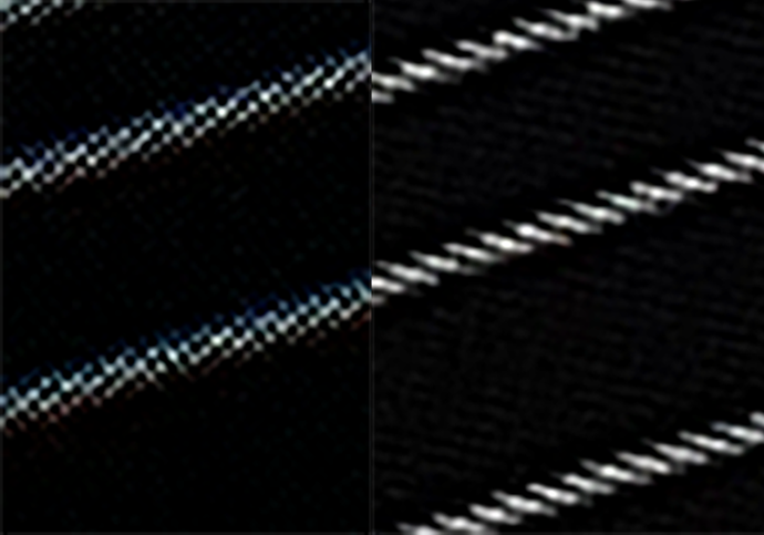

Thank to @SweViver we now know that PieTool updates can improve 8k image:
http://community.openmr.ai/t/mrtv-pimax-8k-vs-pimax-5k-plus-sde-quality-comparison-at-maximum-quality-settings-supersampling-on/8394/165
And from below screen we can see what the scaler is doing wrong:
It seems to be using checkerboard scaling. I’m sure that if it was just duplicating pixels the result would be better.
Thank you very much, I knew something was wrong but I could not prove it or get proof.
That’s not the scaling, but the pixel arrangement of the LED displays.
You’re probably right, so it means zoom levels are different or pixel density is much lower than I’d have expected on 8k. In any case scaler is doing a terrible job, there should be no blue/red pixels and middle of the line should be bright white.
I believe that the point here is that there are clearly black pixels (or holes) surrounded by white pixels in 8K image.
If the original image contained one solid line, even jagged one, any upsampling should again create a solid object. In 5K+ picture it is solid, in 8K picture it has holes in it.
I could accept holes at the line edge, but not in the interior of the line. At least not with the right scaler.

When I look at swevivers zoomed in image of the white lines in the steam vr enviroment it looks to me like the problem is two things.
  1. the pixel arrangement is different, diagonal pattern on 8k, vertical/horizontal on the 5k+ also the 5k+ pixels seem to mostly touch on the horizontal plane so you only really see black gaps between each horizontal lines. (on the digonal lines I see 5 white pixels per line separated by black space on 8k and 3 white pixels per line on the 5k+ that touch each other horizontally). This leads to any horizontal line looking perfectly sharp on the 5k+ while broken up on the 8k (Rephrased the 5k+ pixel pattern gives near perfect pixel fill ratio on horizontal lines while 8k can’t). Nothing can ever be done about this. I don’t think there is any actual pixels showing black that shouldn’t be, I think there is simply more inter pixel black space showing/lower horizontal pixel fill ratio on 8k. The only way to make this match on 8k would be to fit new panels that use the same pixel arrangement as 5k+.
  2. The brightness of what should be a solid white line drops towards the edges. it doesn’t seem to actually blur the detail over more pixels than it should be but the edge contrast is not maintained which makes it very hard for human eyes to see the edges. It’s possible that an edge sharpening filter somewhere in the render pipeline could largely mitigate this for a much smaller overhead than extra supersampling. I’m not sure however if the filter would need to be post upscale in which case it would need to be implemented on the headset which is probably not possible at this stage. If however doing this sharpen pre lens warp or pre transmit over hdmi before the upscale works then this might well end up being a solution pimax can and do implement. It’s unlikely to ever fully match the 5k+ but I would not be surprised if it gets pretty close even at pitool render setting of 1.0. Might not ever happen though.
