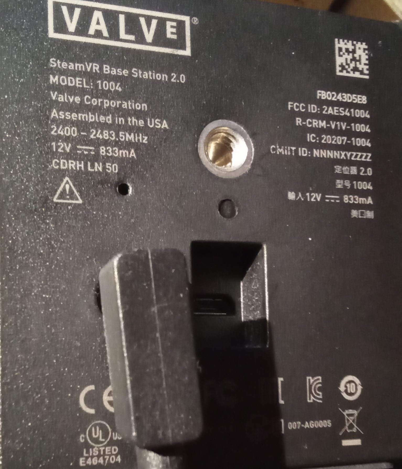

I’ve been talking with Pimax staff directly about the tracking issue and I’ve been told by them that it has to do with what version of base station 2.0s you’re using. If yours are tracking properly, would you mind telling me if yours say “Valve” or “SteamVR” on the back? I’ve been told by Pimax this is my issue but it would be nice to know from another user if this is actually the case. Mine say “Valve” on the back and I got them with my Index controllers on day 1 of the Index’s release.

my base stations are version 2.0 as well. On left top side i have Vlave logo, bot on right sire under serial number it says “SteamVR base station 2.0”

Were they specific about what exactly is the difference between the two revisions which should affect the headset performance?

Unfortunately they didn’t, they just asked which one I had so I sent them a picture and they responded saying, “Unfortunately, this is the compatibility issue I’m trying to solve. We’ll update you on the development schedule later”. This was a month or two ago and I haven’t heard back yet. I don’t expect them to instantly fix this but it would be nice if they kept me just a little more updated on if they were getting to trying to fix this issue or not yet though.
