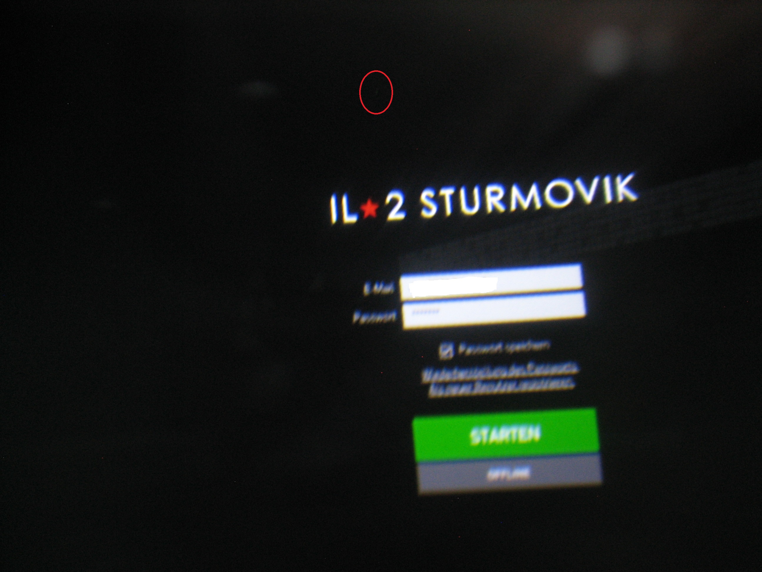

Ok, now that the support has responded me, I have to take a picture “through the lense” to show the dead pixel on it. That is impossible for me. I took about 30 pictures now. Most of them got blurred and on the few that have an acceptable sharpness the tiny pixel cannot be seen. Seems that the support is insisting on taking a photo of the pixel, but I´m not able to.
Does that mean, I won`t be able to RMA my unit???

Thanks for your advise. I already choose one of the start screens of IL2 BoX, where there is a black area in the background. Then I arranged the Pimax in a manner, that the white pixel is showing up on the black area. I can see the pixel clearly through the left lense.
Problem is taking the picture. I removed the head strap and the face foam to get as close as possible with my camera to the screen. But it is extremely difficult for me to get a sharp picture on the photos. I have only a cheap camera and my smart phone. But it is impossible to see the small white dot on the photos.
This was the best result I got. Click to enlarge. The picture is blurry, but at least the pixel is slightly visible, even if blurry.
Problem is also that my camera is producing a lot of white and red dots on the image, which are no dead pixels of the Pimax.
That was the picture I sent to the support, but they asked me for a sharper picture.

I do not want to dispute your claim, I believe it is true, but looking at your picture (even after downloading the full size image), I can hardly imagine that the technical support could accept it as the proof, since there is really nothing visible. Nothing substantially different from the rest of the black area.
There are some other more visible “pixels” around, red and white ones, but not this one, sorry.
I believe the problem is that the picture is really out of focus. Try to get some better camera (ask a friend?) and try again.
What I am asking myself is, why do I need to proof that there is a dead pixel? Why else should I open a ticket and try to return the unit, if there is no dead pixel. If there would be no issue with the device I would just keep it and be quiet.
