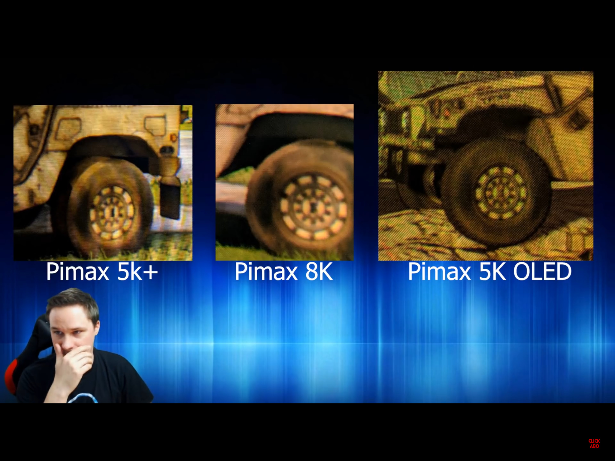

5K BE OLED version has A LOT more Screen Door Effect when compared to the the normal 5K+ , This is worrying?

5KBE is pentile type OLED, which means right off the bat it is quite a bit worse than the 5K+ that uses RGB stripe.
Pentile is a fake resolution plague.

Well ive decided im gonna cancel my order an get a 5k + standard version instead, that SDE on the OLED version is too much for me, it would drive me mad.

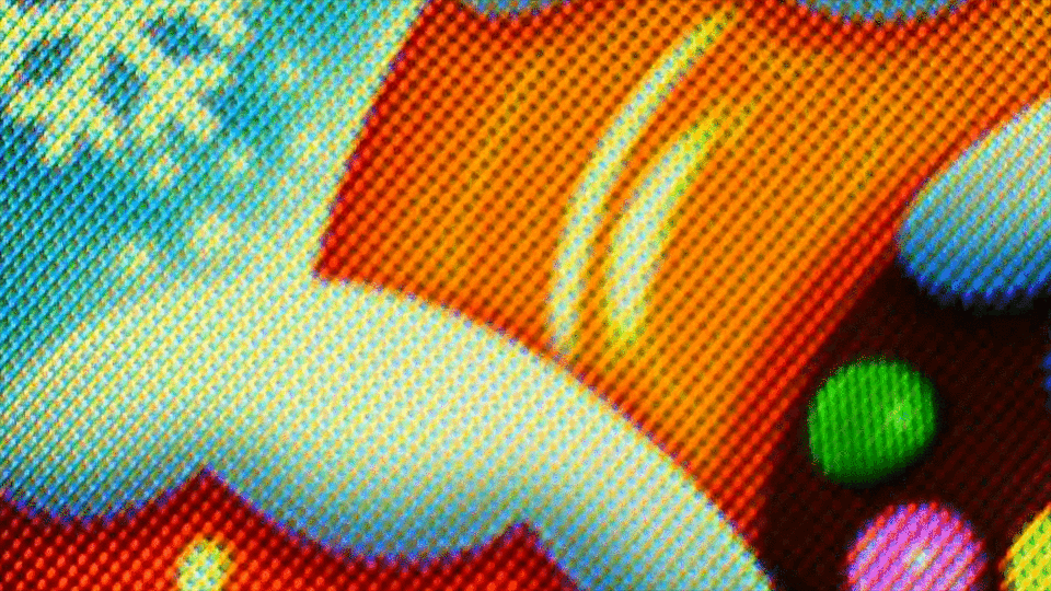

There are pictures from “skai” from a pentile with anti glare screen protector:
https://community.openmr.ai/t/anti-sde-for-pimax-5k-be/10466/26
My wish:
Better photos. Exact the same area, text in different sizes, lines etc…
A test image. With, and without filter.
And side by side, and here embedded.
For now, I have made a comparing gif from skai’s pentile pictures:
Original, two layers (anti glare screen protector) and 4 layers.
Is there an owner of Odyssey +, he could possibly open it and take photo with and without filters :-).

Perhaps, a Anti-SDE-Filter is THE solution, a compromise for undecided backer/user.
And on this pictures, this is only a “misused” screen protector.
A special “Anti-SDE-Material” should be better.

No, due to the higher SDE, smallish text would be much harder to read on the 5K BE, due to the PenTile OLED layout.
german but just look at the pictures. :wink:
The BE OLED ver is about vive level.
5k+ / 8k are both pretty much where SDE is no longer an issue for those people who it bothers, 8k is a softer image the 5k+ is sharper but slightly more of a grid is visible. i wouldnt call it SDE tho.
