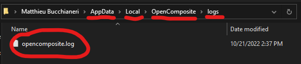

Where do you get the open composite log? I only see the switcher? Sorry I’m a noob.

Here it is! thanks Matt!
Thank you but that is not the file my link asked to grab
