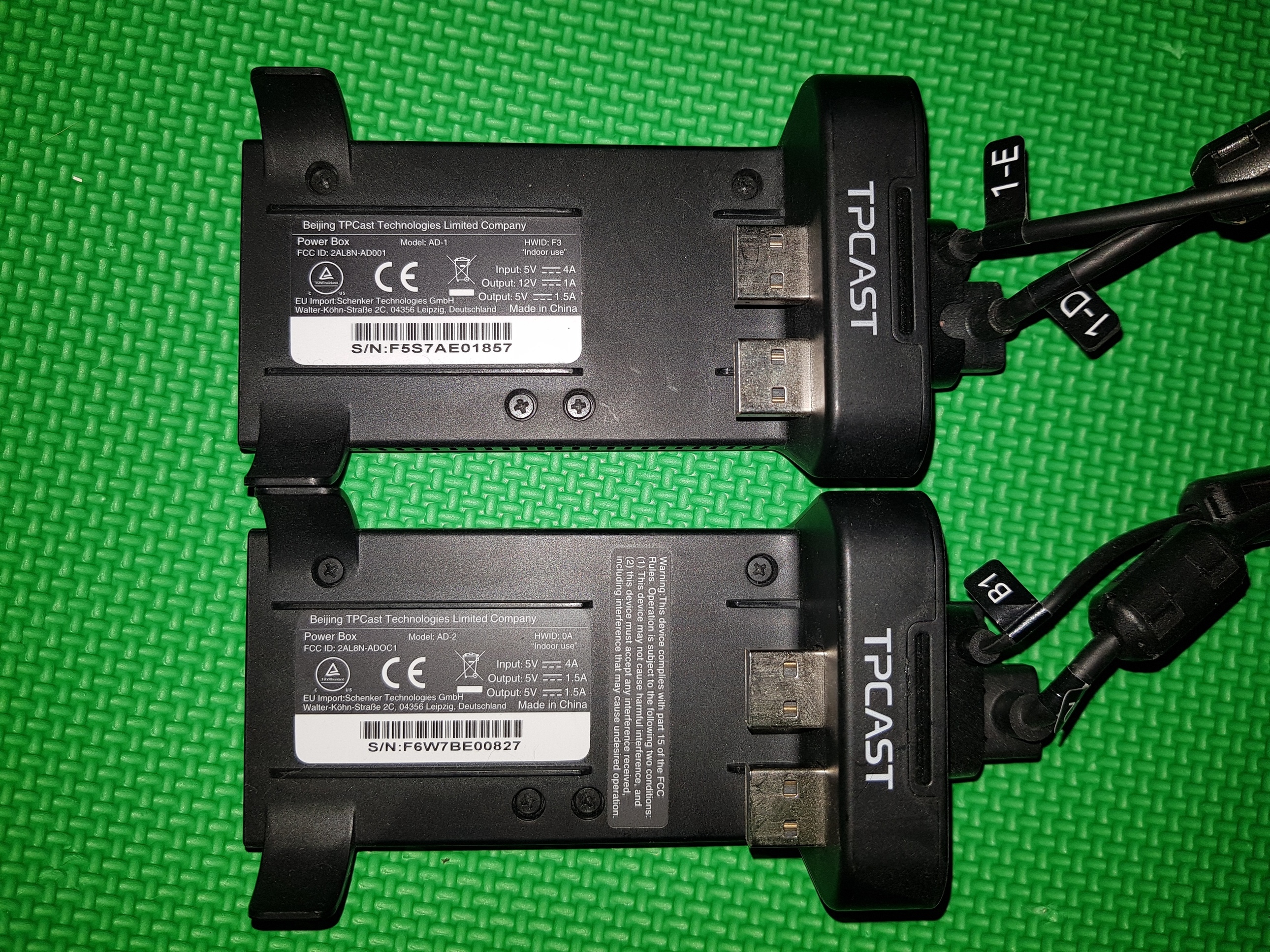

Its not that easy. Btw TPCAST was very clear saying “Do NOT use the Vive TPCAST battery adapter with Oculus TPCAST”. I assume u may fry it…
Took a fast photo…
Upper: Vive TPCAST
Lower: Rift TPCAST
Notice, except different output A, the Vive uses 12V where Rift uses 5V.
Ok No Descriptive Answer lol (NDA)
ok i wouldn’t try then either. But isnt it possible the divice would check how much Volt and then adapt to it? i mean technically “Adaptive Voltage”, and then they could have sold a single one that would work with both? (if they wanted to do that)
