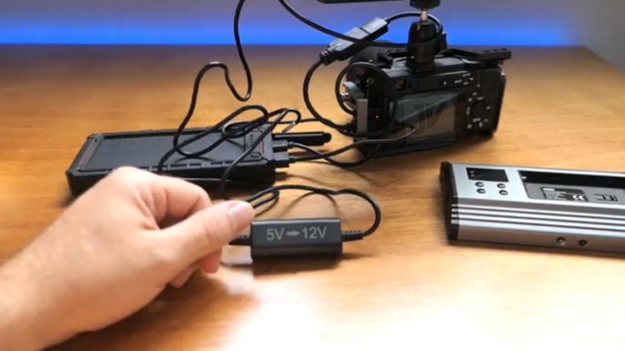

Will this usb to 12V work on pimax 5K?
https://www.amazon.com/KUNCAN-Converter-Cable-Voltage-2-1mm/dp/B01ID90K4A/ref=sr_1_7?crid=337NDIUO7XBOB&keywords=usb+to+12v+adapter&qid=1554153442&s=electronics&sprefix=usb+to+12v%2Celectronics%2C113&sr=1-7
also
I would say no. Pimax wall psu is 12v 2amps
That stepup Specs
5v 2amp input
12 1amp output with rec max .8amps.
@Heliosurge
Well Helio… i ordered one from amazon prior to your reply. It came today and it actually works, I just played 10mins of ED using this stead the psu. my main usb goes to a usb 3.1 and this went to a 3.0
I am sure some power loss somewhere but I dont think i want or should push my luck as my hmd has no issues.
Good that it works. I would be careful. But it seems the 5k might have less draw for 12v.
There is an adapter posted on the forum to use a Sata or molex psu connector for the 12v supply for use with headset.
