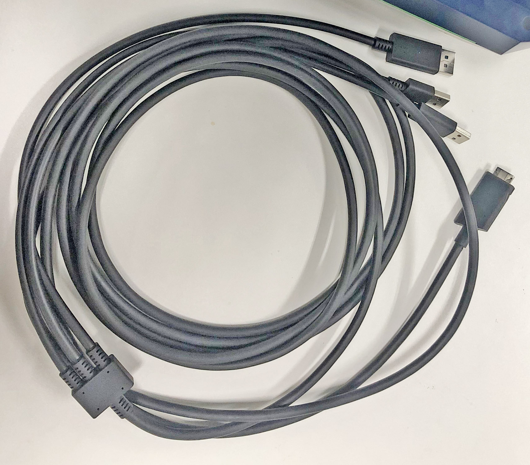

These days, we’ve been testing for Fiber optic. and will let you know the results. Currently, we just passed the testing for dual usb cables on 8KX. one usb cable is for both charging and transmission; and the other is for charging only and able to be plugged into a normal adapter.

So the new dual usb cables for the 8KX (that I believe you got in today) have passed have they? (I’m assuming they are dual USB as you say but the picture that Matthew posted today looked like it had 3 usb ports!)

That looks like 2 Usb and 1 DP on one end, and the custom Interface on the HMD side.

Exactly, well spotted. It’s Dual USB as shown.
