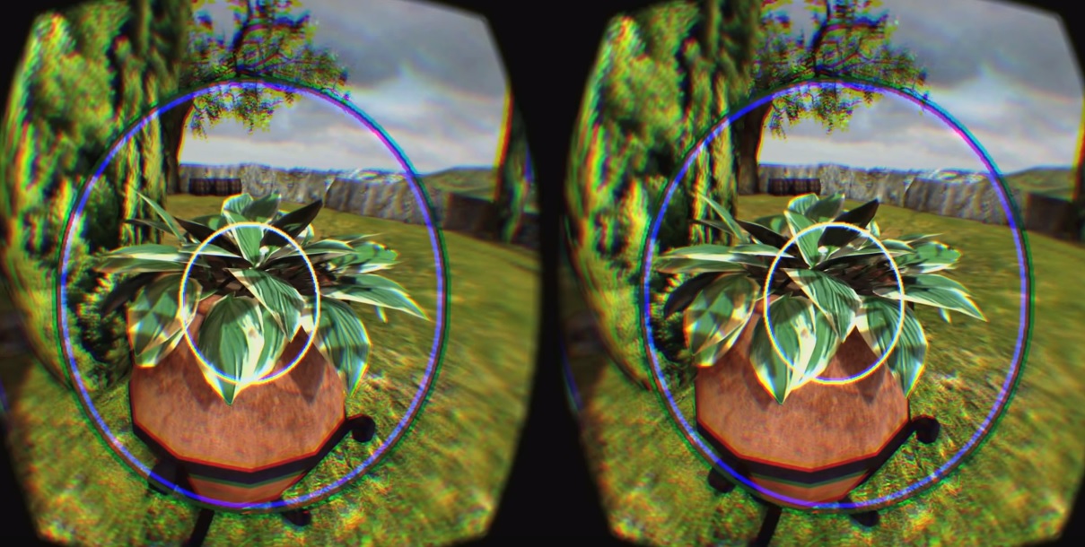

After reading what @Sjef said. The foveate rendering will simply increase Level of Detail in the area your looking at. The area outside the foveate will render with less detail.
The effect this will do is reduce gpu workload by varying details. So it won’t render an area at a higher res; it will simply focus details within your view so to speak.
So in terms of benefit? Where without foveate rendering you were only able to have medium quality max for good performance you maybe able run at high or ultra. If i understand correctly; game is likely to require native support for foveate however a software driver may be able to do a kinda workaround.
@Heliosurge My understanding is It is about resolution. So the area where your eye focuses is native res, the next area outside that might be 75% res, the area beyond that is 50% res expanding out in a circular pattern rather than a full frame rectangle resolution. This would also support super sampling. so the area where you focus could be x2 and downscaled.
Then the game could have any number of graphical options that affect the entire foveated area.
So then would mt first post seem reasonable in how it could work with potenially foveate area could be rendered near full native res?
That’s correct. Full res would be a small area in your focal range. It is almost like dynamic resolution linked to your eyes.

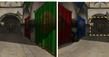

This article has more eye candy how it works visually from the Google Daydream devs:
The engine has less work to do so fps (or resolution) goes up. The bandwidth drops as less data needs sending to the HMD so this could benefit wireless or portable devices too. It’s a lot of aspects but certainly where we have to go.
