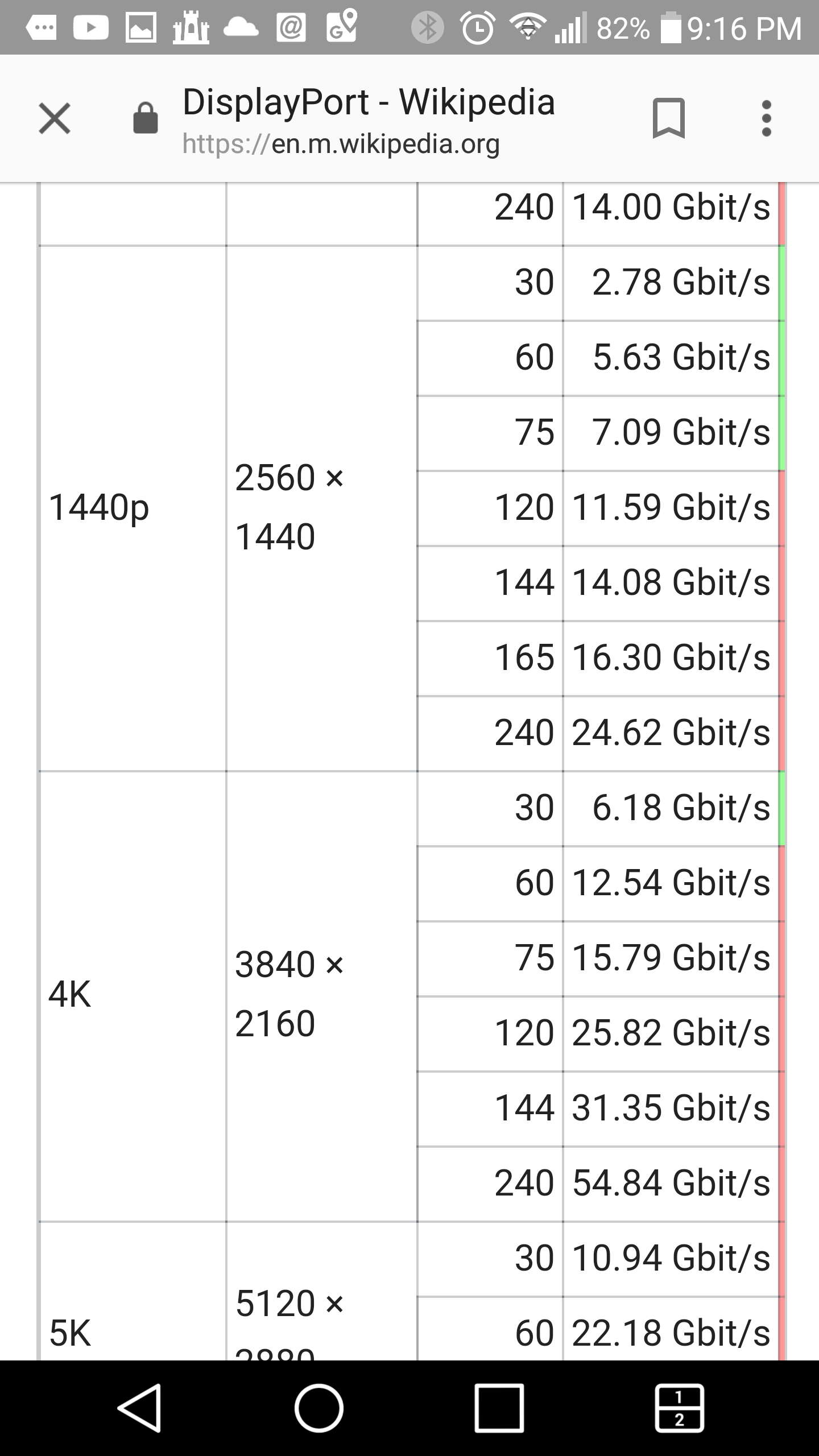

Okay will use the search function to find my post on dp 1.2 specs (dp wiki)
The dualb1440p input roughly adds to 4k. Dp 1.2 can do 4k @ 75hz.
Link for your reading pleasure.
Below are highlights to save time.
There you go bandwidth & what bandwidth needed for resolution.
Thanks, at a glance yes looks like DP 1.2 should support both the 8k and 8k X with the required resolution/frame-rate

So… if I am reading everything correctly, it would just mean that the refresh rate would be 75hz with a DP1.2 port.
It should be a refresh rate of 90hz for a DP1.4 port.
Provided I understand everything correctly, am I right @Heliosurge?
From what i read of dp 1.2 yes its probably going to run at 75hz. Which being the minimum recommended spec gpu makes sense.
But surely running at 90hz will provide for a better experience?
Well to get 90hz you have to have a better video card. A 980ti amp extreme falls under the minimum recommended spec, it can’t do the 90hz at 4k. It should be able to do the 75hz though.
