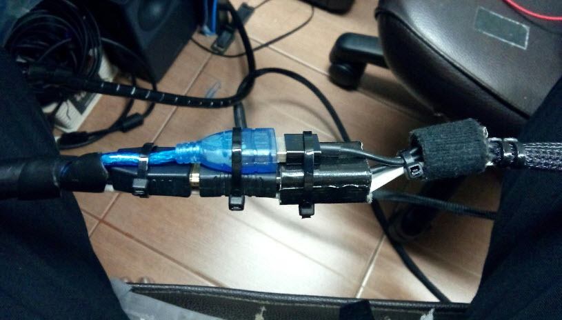

Wondering that, since I need extension for Pimax, anybody knowing if the “HTC Vive Link Box” will work.
I’ve heard you can use simple hdmi extension cabel and it works fine.
Thank a lot industria, btw I did.
Just wonder if it’s, will be less messy than what I’m having, ha ha.
Those are pimax hdmi+pimax usb+leap motion usb.
Its fine until it works :smiley:
Anyway, if you’re from europe you can easily buy htc box from amazon and send it back if it will not work :slight_smile:
I was trying an extension for my pimax but I only have a green light on the headset. Is it because it needs more power to like and there for a link box? Been waiting 2-3 weeks from amazon for my link box. Is it necessary?
I needed to use a 4K HDMI repeater otherwise the signal gets to weak. Also needed to buy a USB 3.0 extennsion cord to get enough juice to the headset. But now I can move to another room if I wanted with my +5m cord :slight_smile:
