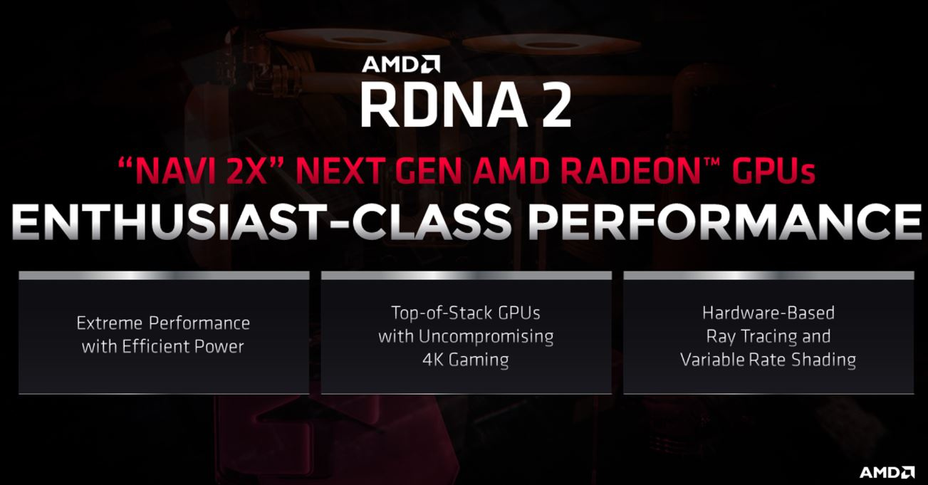

“There’s still no explicit word (yet) on how ray-tracing will work on next-gen Navi, but it will be a hardware solution, with support for DXR 1.1. Furthermore, RDNA 2 will join NVIDIA’ Turing and Intel’s Gen11 GPUs in supporting variable-rate shading (VRS)”.
Source: AMD RDNA 2 With H/W Level Ray-Tracing Support, VRS and 50% More Perf-Per-Watt Coming Later in 2020
