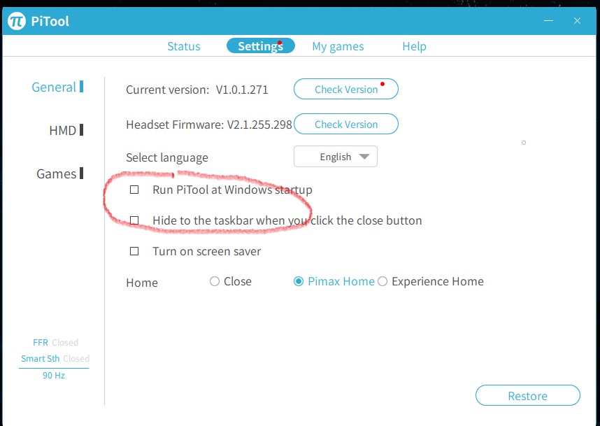

To turn off pitool complete, dissable this:
