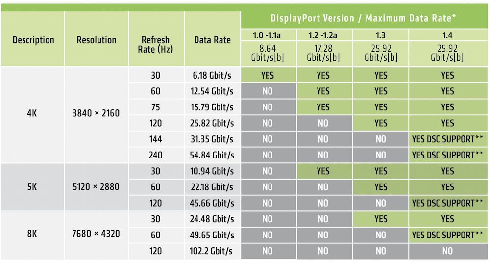

@kw23 Well…to be honest the changes from 1.2 to 1.4 are quite something, maybe you wanted to say that the two are just backward compatible… :slight_smile:
Here’s a table with the differences:
A DP1.2 cable may work, but there couldn’t be enough bandwidth for high refresh rates, or worse, noisy signal, and Xunshu once confirmed that the new Pimax headsets use DP 1.4 by default.

but in the picture above 5k+ needs about 32gbits for 90hz ? whit ss ? or i missing something
or the cable only need to be supporting 1440p ?

So obviously a 2160@60 hz rated cable is good for 2 x 1440p @ 90hz. I’m lost.

“DisplayPort cables are not classified by “version”. Although cables are commonly labeled with version numbers, with HBR2 cables advertised as “DisplayPort 1.2 cables” for example, this notation is not permitted by VESA.[36] The use of version numbers with cables can seem to imply that a DisplayPort 1.4 display requires a “DisplayPort 1.4 cable”, or that features introduced in DP 1.4 such as HDR or DSC will not function with older “DP 1.2 cables”, when in reality neither of these are true. DisplayPort cables are classified only by their bandwidth certification level (RBR, HBR, HBR2, HBR3), if they have been certified at all.”
In plain English, when you’re talking about digital cables, a cable with good build quality made during 1.2 era and for 1.2 specs, may still be easily able to handle higher bandwidth and 1.4 specs. It’s a bit hit or miss, there’s digital correction, you may not really notice if a cable is borderline, as your hardware will compensate somewhat, but if you buy a quality extension cable, you will probably be fine.
The actual bandwidth/handling of a higher quality cable and length it can go can be very high if they’re using good shielding, higher gauge wires, careful pair twisting, etc.
