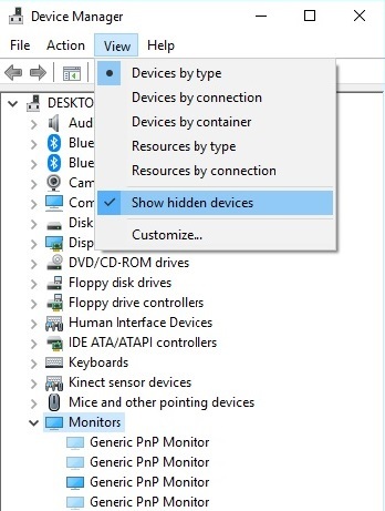

May have to uninstall any unused hidden Monitors in Device Manager.

What do you mean hidden monitors?

Uninstall any non-used Monitor if present.
