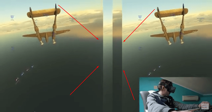

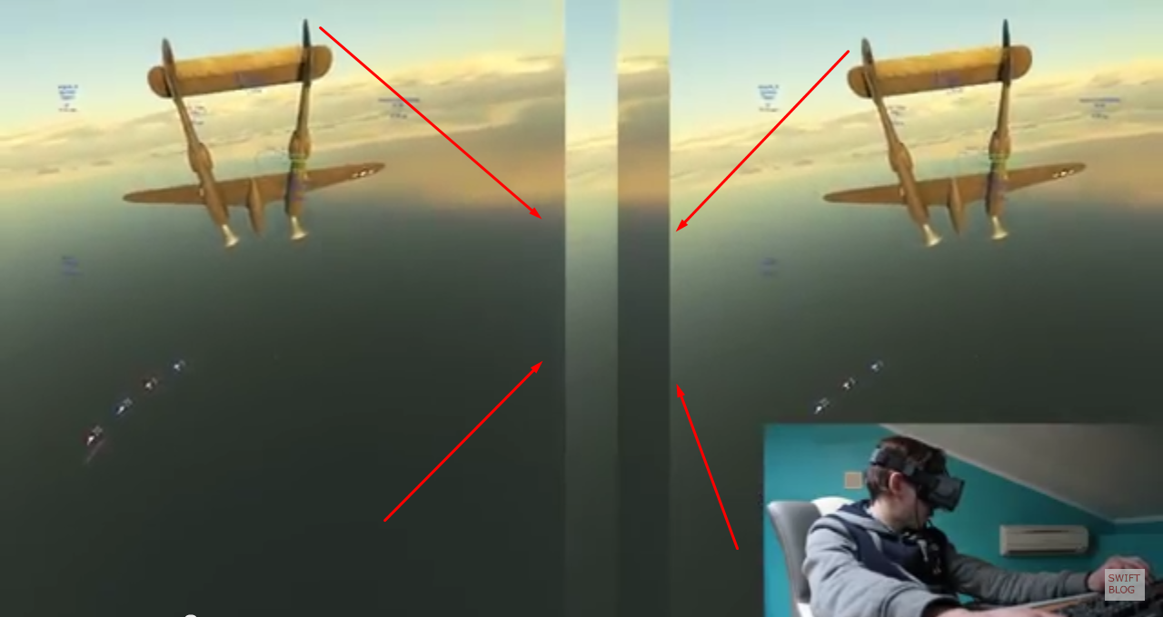

Warthunder render issue?
Warthunder has a very annoying issue (see a picture or video) and i guess it happens only to pimax headset.
Screenshots and the video are from web
Is here anyone who plays warthunder and has no such issue? Any solutions how to resolve the problem?

Just tried as described above using new 1.2.57 open local. I am wondering if this is just how Warthunder does it’s VR. The cockpit view is a bit blurry and the sights are unusable? Is this just the case. I can see the cut off portions in the corner of my eye at the edge. Note I am getting this "binocular effect probably because the foam could be a bit thicker. I just want to confirm that the split screen on PC monitor does or does not look like the above screencaps.
I got the same binocular effect, but since I play Elite I can at least pretend it’s part of the helmet
“Open locale” haven’t helped me as well - game still lunches in steam VR mode with this weird separations in the middle and I believe they affect in headset image as well - I think thi is what makes “sights unusable”
In I do think that this is not “just how Warthunder does it’s VR” because other screenshots (made on vive or oculus) on the internet does not have this weird look.
