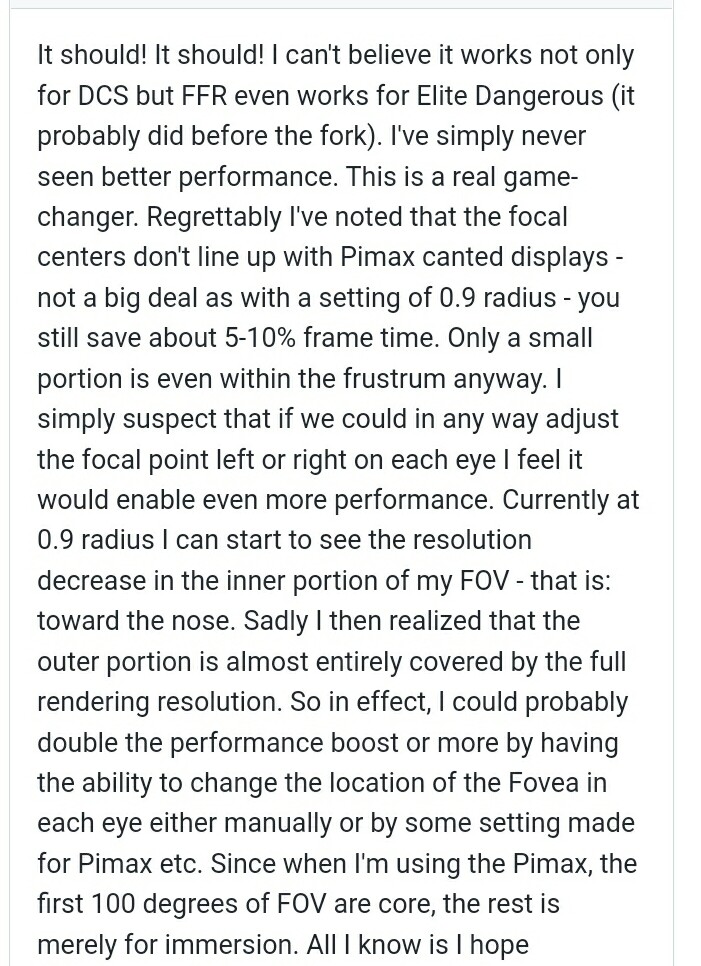

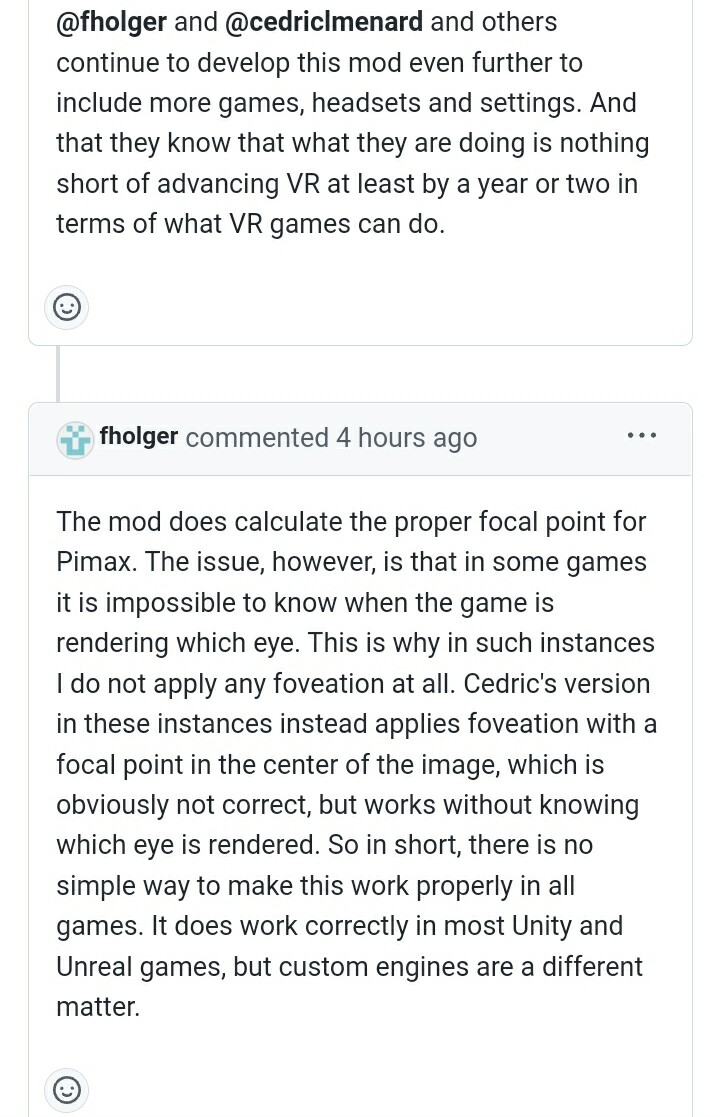

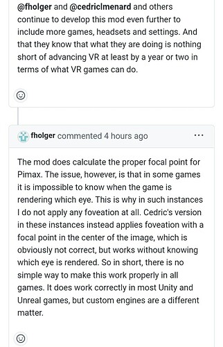

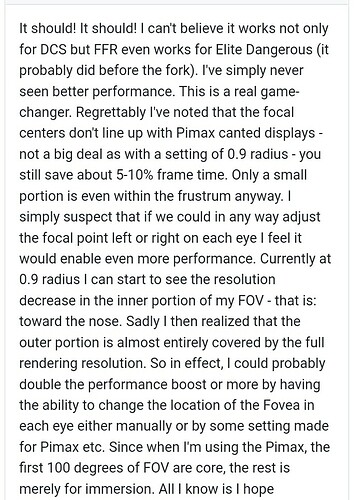

I just found out that someone created a fork that works with DCS and Elite Dangerous here
