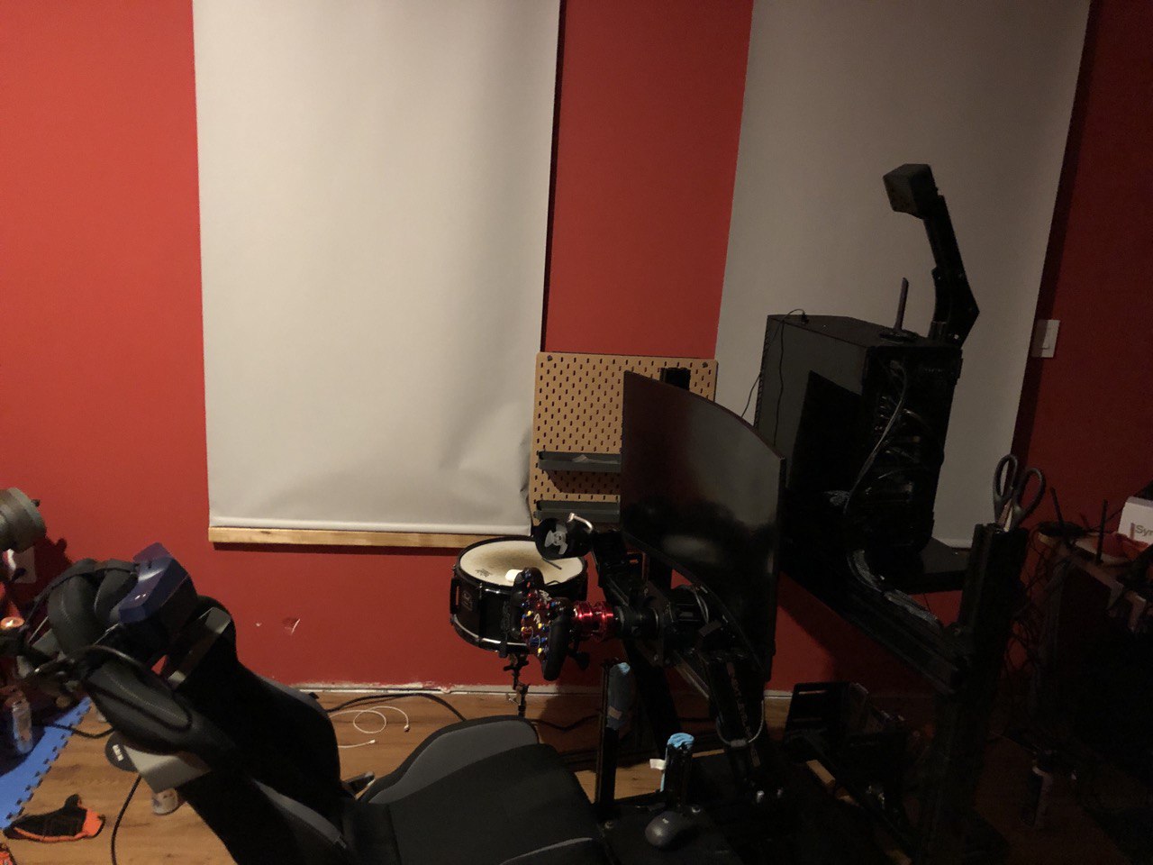

VR seated position anchor center to base station position for simracing?
Sorry if this is in the wrong forum section, new here. My problem is simple:
I am always seated as I only simrace and only play iRacing, thus centering is always a crap shoot. Sometimes you get it dead on and theres this truly immersive feeling when its dead on, but I only get that like 5% of the time. The rest of the time its “good enough”.
I have my base station centered perfectly in front of me. What I want to do is build some sort of basic application that will center the HMD to the base station. My goal is to always have the car pointing at my base station.
I’ve been programming on the web side for a long time now but I am fiending to develop this app because I need it so bad. Can anyone point me in the right direction? I’d also be happy to hire someone to work on this for me.
Thoughts? I legitimately cannot find a single topic online about “perfect center” or “anchor VR to base station” etc. Crazy!
In a nutshell, I want to lcok the “forward” direction of my VR so that its anchored to my base station, so if I “reset HMD” while im 1 foot to the left of my rig, it wont define a new fake center in my world, but always look towards the base station

Done thousands of races with this setup, works perfectly. Just want to anchor forward orientation to base station. That would solve all of my problems.
I basically want my “line of sight” to always be going through the base station.
That’s the problem with a base in front of it. Since the base alternately sends two moving IR lines through space, the HMD cannot reliably determine a fixed coordinate at launch due to the narrow angle. So you have to center manually.
From the Side gives the HMD more information because the grid is offset.
But I will still have to reset my HMD in game. I have done absolutely everything under the sun. I have done offset before. I have done two base stations. I have to center manually anyways. When I center, I want it to set one coordinate, not two. I just want to build exactly what I described in this thread or find another existing solution if possible. I’ve simraced for years and I can never get dead center in iRacing without pressing recenter HMD and moving my head millimeters in various ways. I need to anchor it to base station. I’m really not looking for base station orientation advice as I’ve spent years on this and it’s driving me up a wall :joy:.
I think it doesn’t really matter if my play area or whatever is perfect, because the game doesn’t seem to anchor to anything until I press recenter, at which point a fictional center in space is defined.

Can you give me a bunch of details about your setup? Do you have pics of it? Are you saying you launch flight sim and its simply centered, you dont need to hit a “recenter HMD” button? What type of base station(s) + headset?
Yes I’m well aware of PiTool, I’ve done thousands of races and have been tweaking this for years now. I sitll have to hit “recenter HMD” in game and wiggle around.

My base is about 4 meters sideways, 60 degrees offset, 20 cm above my head when sitting in the rig.
Just put yours somewhere to test it, it doesn’t have to be screwed on.
