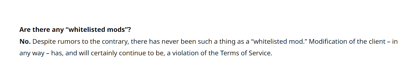

I usually agree with Thrillseeker’s assessments, but this time I am not convinced by his take on VRChat supposedly changing direction and “going corporate”. I think VRChat made a very boneheaded move, and I’ve been upset about it myself. But I also think there’s a lot of misinformation and hyperbole out there about this whole thing.
In regards to this video, I don’t think this actually represents any big change in direction for VRChat. Its stance on mods has been consistent throughout its existence. It has actively sought to enforce its policies on mods the entire time, and within the last year VRChat started rotating tactics in that effort. The only difference now is they hit on a tactic that finally actually worked.
Thrillseeker asks the question in the video why didn’t VRChat implement these features and fixes the community was asking for long before now? And as I mentioned earlier in this thread, I believe the answer is because the mods existed to solve those needs instead. There was already a solution, so the community wasn’t demanding those things from VRChat, and so VRChat worked on other priorities instead.
Something good that comes out of this whole nasty situation is that VRChat building these features into the stock client will now mean that everyone gets these features, not just the people on PCs who were willing to break the AUP and risk being banned.
The claim that VRChat doesn’t listen to its community anymore is hyperbole. And that arises from all the anger that still surrounds this issue. VRChat made a serious misstep in how it handled its community when it deployed EAC, but it has been making every effort to try to make up for it since then. And I think that does count.
