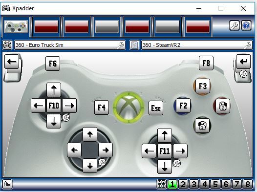

Look into Xpadder or something similar, it can translate keyboard/mouse input into just about any game-pad input.
For instance, this is my Wireless 360 controller settings for Virtual Desktop/Kodi.
FPS games for PC without native game-pad support performs sub-par. The aiming ability will be more difficult because there will be no assists.

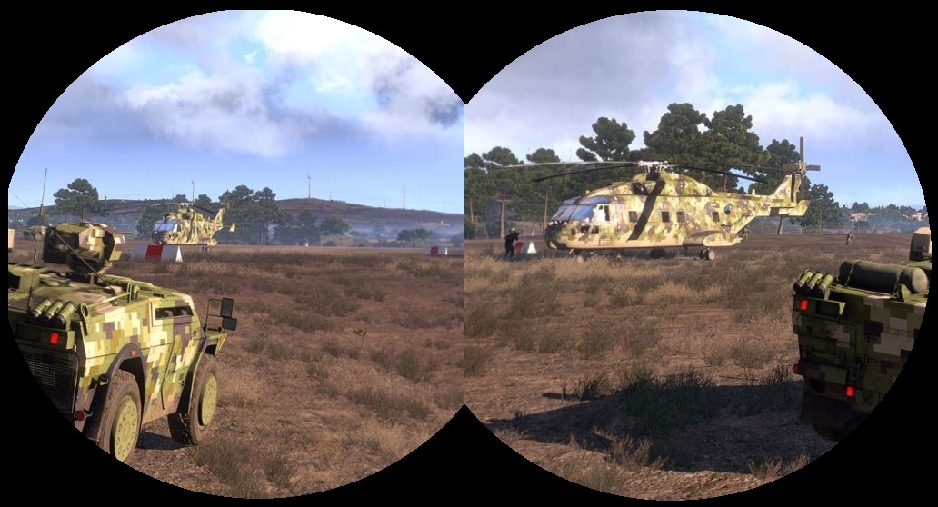

@grzvs thank you! I did the same, but I still have some problem … here that’s what I see when I run Arma 3 and I can’t figure out how to solve it …
