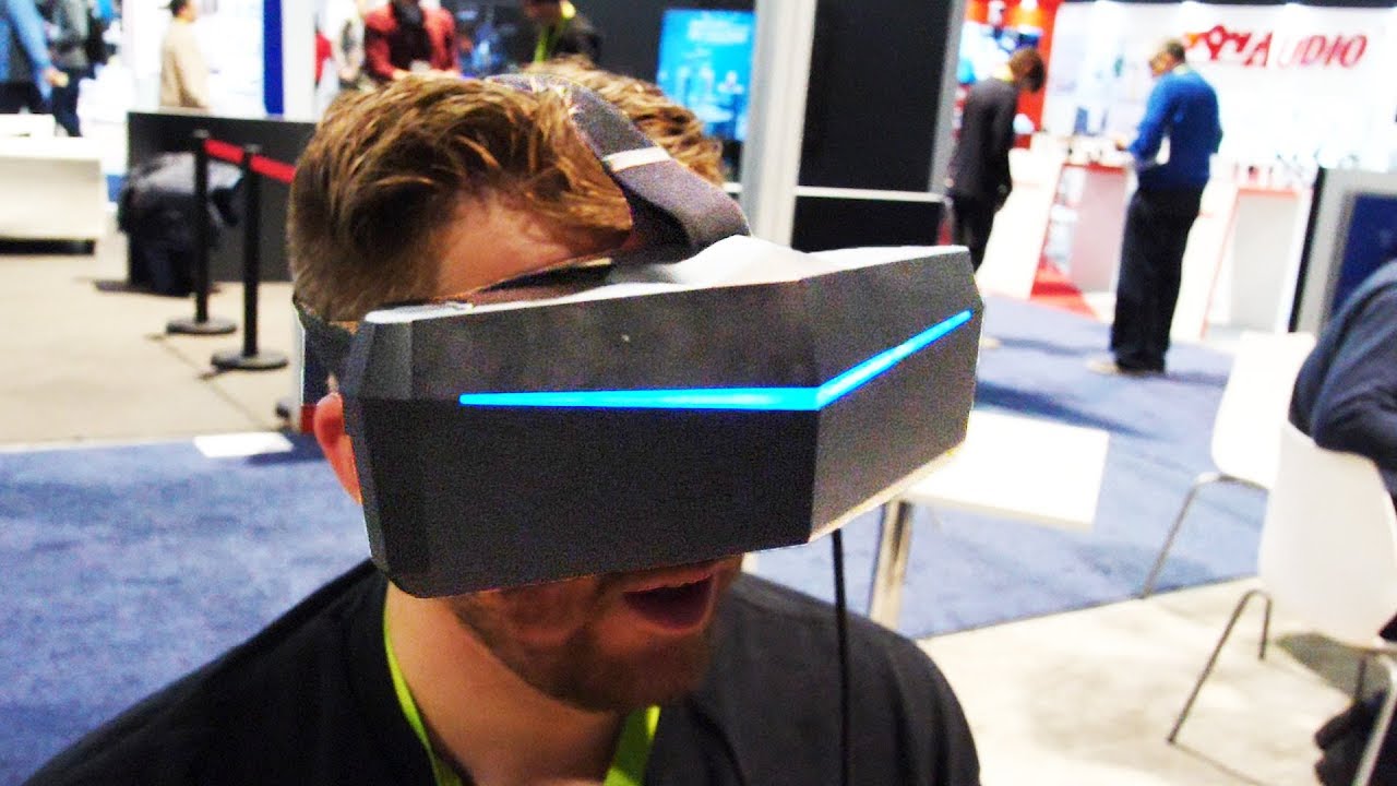

So generally it’s really the display panel industry that’s the problem. Pimax is the only one using 4k panels. Only LCD 4k panels currently exist and they have their own set of drawbacks (like black level in the Pimax 8k isnt good at all). Also Pimax just used a standard 4k LCD panel, I think exactly the same one Sony uses in their premium phones. Using a standard sized panel comes with its own set of challenges when designing the lens. I think this is the main reason that the Pimax 8k lenses can only see 50% of the panel.

No sure why you insist that the Pimax8k can only use 50% of the display area. From en engineering point of view it would be completely nonsense. So it looks like your on some kind of super weird FUD campaign.
Not sure what PimaxVR is doing and where they get their lenses from, but technically it’s not impossible to get well beyond 80%
although i don’t expect PimaxVR using high precision quality products from Jenoptik, but in principal they use the same technology for sure.

Hmm that would be super weird indeed, even more so because of the backer meeting next week. If I’m wrong then people with Pimax 4k could easily confirm that it was all BS what I told you guys since SDE/resolution should be at least on par with the Pimax 4k. Why would I do that? That would just be super weird indeed!
Because the info you have is flawed. See the topic your tagged in & it should hopefully help resolve it.
http://community.openmr.ai/t/angular-vs-parallel-magnification/7687?u=heliosurge
So yes looking forward to the results if the backer meet & having eggs fir breakfast. :v::sunglasses::+1::sparkles:
Well I know for a fact some of the testers complain about SDE/resolution (at least noticeably worse than the Pimax 4k). Explain that to me then. Also I’m not sure if your theories are correct about the lens angle, I’ve never seen the 8k myself.
You know I am limited on what I can & can’t discuss.
Ok well in 8 days you guys are going to have to discuss this anyway because I’m sure some backers will notice too and will start asking questions.
What i will say is think about the lense experiment proposed & read that topic. While it won’t answer all it will establish that lens test is flawed as that applies to parallel screen to lens. Special lenses are required to see the screen on an angle & look like its not being viewed on an angle.
Worst than 4k but better than vive pro? because some people tested the v5 said that the sde and resolution was better than vive pro. Pimax change something in m1 and m2 that made worse?
Well, Vive pro is 2 * 2880 * 1600 = 9.2M
If 50% is correct, then Pimax 8k is 50% * 2 * 4k = 4k = 8.8M
However spread over 60% more Fov. So should be worse than Vive Pro indeed.
It could be that tests that have been done are flawed, I’m not going to dismiss that as a possibility of course. Yet fact remains that some testers, coming from the Pimax 4k, where quite disappointed with the SDE/resolution when they first put on the Pimax 8k. So I’d still think there’s something really flawed in the Pimax 8k.
but this guy thinks that pimax 8k is better than the vive pro in resolutrion, and almost no sde, just a little of blur.
So they change something…
Well lenses obviously changed a lot. So that could explain it.
so pimas says that new versions are better but in reality are wosrt. i just dont understand nothing. just better wait for the meeting.
Assuming all achieve same lens quality taken Oculus CV1 as the base comparison in my model the 2eyes resolution potential per degree of field of view diagonally of a Pi4k is roughly 184% and the Pi8k is the same. Whereas on a single eye the Pi4k can do 195% vs the Pi8k only 165%. The Pi8k will have less resolution per eye pDFoV as the Pi4k, that is almost a given.
SDE is not equal to resolution, it is loosely coupled. I expect as little perceivable SDE as with the Pi4k in the Pi8k, 5k should not fall behind by far and end up comparable to PSVR, just being way sharper (110% single eye).
Whatever the claim is on usable display area, it all comes down on how much worse or better they are compared to CV1 and Pi4. And there is not a single good reason why they would in this case be substantial worse than all the other examples.
The big if with wide FoV is rather how you manage to stretch out the used display into peripheral vision area vs. concentrating it on focal view with stereo overlap. And then that is the point where in the focal area they achieve more than 50% usage of the display. If we only talk about that area that figure would be reasonable to discuss.
AFAIK in that video he tested the Pi5k first and compared it to the VivePro. Claim was better resolution but in my model the Pi5k has slightly less resolution pDFoV but way better SDE, so this could have made him think slightly better res. With the prototype of the Pi8k he is just blown away… so lets assume the Pi8k can do more display coverage than the VivePro, i think it would be reasonable to settle on that statement @Sjef
