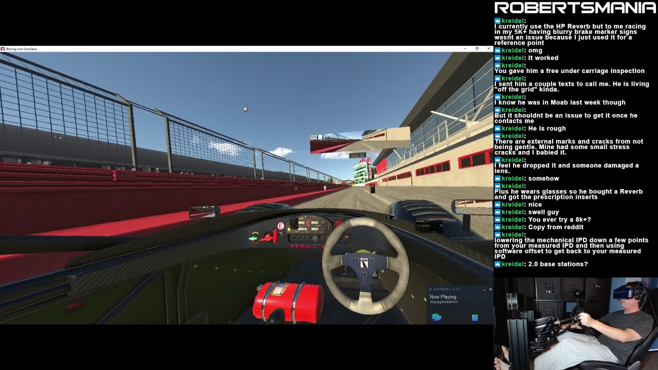

I use a Pimax 5K+ with iRacing now and recently received my 8KX. Here is a rig workshop stream going through the software and hardware setup.
My 5K+ has been running on a really old PiTool version 144, so I first wanted to go through updating the Nvidia GeForce drivers and PiTool to the current versions making sure at each step that the 5K+ was still working okay.
Then we transition to the 8KX and initial impressions.

0:05 - Starting with a screenshot from the 5K+. Goal is to compare the same car/track/conditions.
3:20 - 8KX connected. Set SteamVR resolution to be consistent with what we were using on the 5K+.
8:01 - Initial focus observations with the 8KX. Ever so slightly out of focus in right eye unless I shift the HMD.
8:43 - Grab initial 8KX screenshot.
11:57 - Realization that distant objects are not rendering the same on the 8KX - iRacing LOD system.
17:05 - Changing iRacing LOD option to not drop out world stuff. Was set to 75Hz, so a little unexpected that it would look different than on the 5K+.
23:43 - Screenshot comparison 5K+ on left, 8KX on right - both at nearly identical resolutions. The pixels being rendered appear identical, which is good and what we expect if SteamVR and iRacing think they are rendering the same resolution.
27:55 - IPD adjustments. Cranked all the way down, its not quite in focus for either eye. Moving the HMD slightly to the left makes the right eye pop into focus, and vise versa.

Try to remove the facial cowling and move the headset closer to your eyes (not as practical solution, just a test). The fact that tilting the headset towards one side improves focus for that eye leads me to speculation that just like me, you need to get the lenses closer to eyes.
In my case it is rather prominent as I can see only 1/3 of potato FOV clear while inside, outside and and downward it becomes blurred and distorted.
When I remove the face cowling and press the headset as close as physically possible the image significantly improves to the point that large text like in PE is still somewhat legible at the edge of small.
