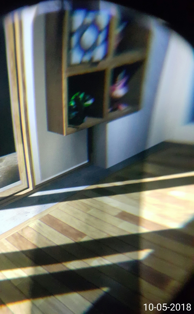

And, as promised - the photos.
That dosen’t look like the defogger but might be related. Will need support for sure.
Added these pokes

The picture is in general the same as on the photos I published above.

Since the issue fixed itself before support should setup a skype with teamview. Since your issue is not being experienced by other users. There might be some componet failing or some random software conflict. If you have another pc or can use it on a friend’s I would check & see if it’s present on another system.
please shift to video mode to play a movie, could you still see the same issue on display?
Yep. The picture stays equal no matter which mode is on.
