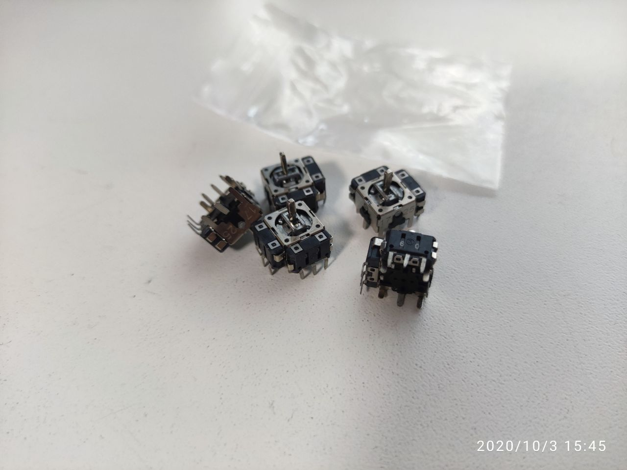

I bought these sticks, they are ideal for Index controllers.
The left thumbstick began to jam along one axis and drift, that is, the movement continues when you release it (forward / backward).
This detail, which is in the black stand, needs to be changed in the thumbstick of the controller so that there is no drift (it is about 3-5mm wide)
I used this fix instruction.
There you just need to replace, no soldering.
https://www.reddit.com/r/ValveIndex/comments/g7oqem/i_found_the_cause_of_stick_drifting/
Replaced this detail today.
Here comparison are my new and old:
