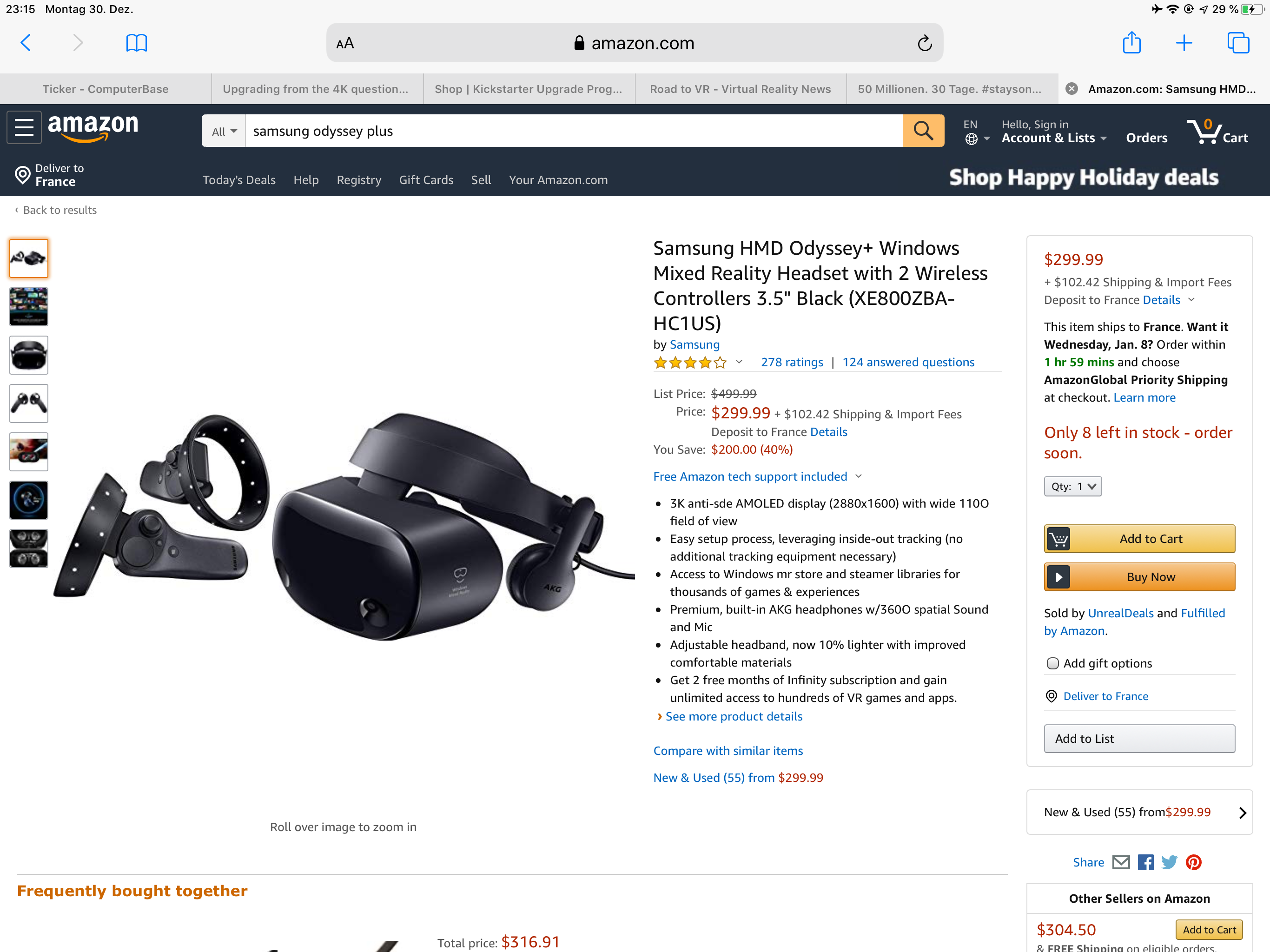

So personally i would suggest you to buy the Samsung OD+. Tracking is not as perfect but works fine for me in 99% of the games (yeah, i play even FO4 with it without problems), has even better sde than p4k (picture a little less sharp but oled blacks and as a whole waaaay better than p4k) and can be bought insanely cheap. There is no better headset out right now in terms of price/performance. And then save for the real next gen hmds like 8kx or whatever comes around.
@mr.uu I’ve spent half a day googling the differences between the Pimax 4K/5K/8K and the Valve Index, but one thing I couldn’t find is whether the 5K itself would be a good upgrade from the P4K :). Probably because the term “4K” is used when referring to all the other headsets as well, so it drowns the P4K itself. Anyway, thanks for the “it will be a MASSIVE upgrade” part, that settled it.
Now concerning the OD+. Sounds like a good idea, I never imagined that a WMR set could be an ungrade over the Pimax, but it’s like I am living in a state-owned 5-year plan economy. Samsung.fr = doesn’t know what an “Odyssey” is. Amazon.fr = nothing, but at least has some accessories. Finally got one link on Microsoft’s US store site, out of stock of course, and they don’t deliver to France anyway, and the link on the microsoft.fr site links to the page on the US site :). Local brick and mortar stores, yes I am willing to go old-school, they don’t want my money either. Never mind then :).

Going to amazon.com (EN), shipping to France worked for me:
One thing to note: i just read in another thread that some had a bad experience with support with samsung with an imported headset. But its Amazon, so should be hassle-free to send it back in the forst two weeks…
