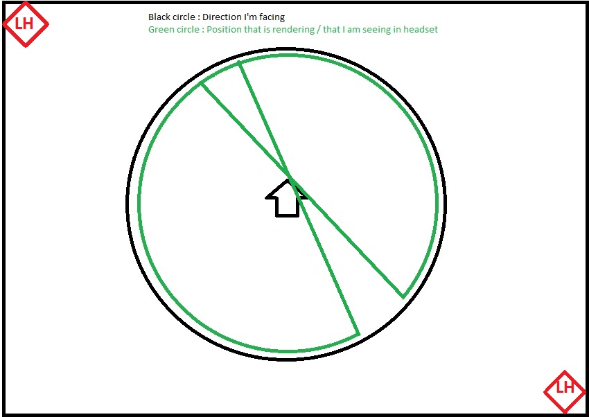

I’m having a weird issue in some games.
Basically when I turn to one spot (always the same), the headset will show me the opposite direction. If I keep turning, it will go back to normal.
I drew a sketch to try and illustrate the problem.!
