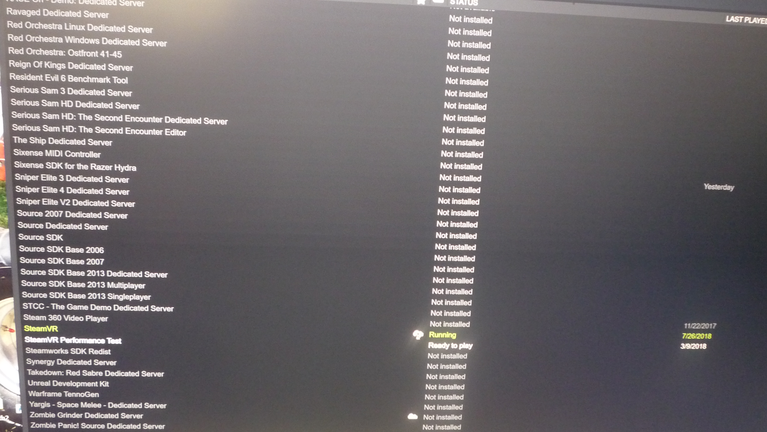

Im not sure where to find the “steamvr” driver for the Hydra controllers?
I did however install the Hydra drivers from the Razer website
You might need yo uninstall the Razer Drivers to get it to use tye special steamvr driver.
The Steamvr Driver can be found in the Software under Library.
Ok Ill give it a try, “back to the drawing board”. Thanks
Try the Steamdriver first Library\Software tools
I should see Steamdriver correct?
I will take a look when I get home. In the meantime this should work a store link.

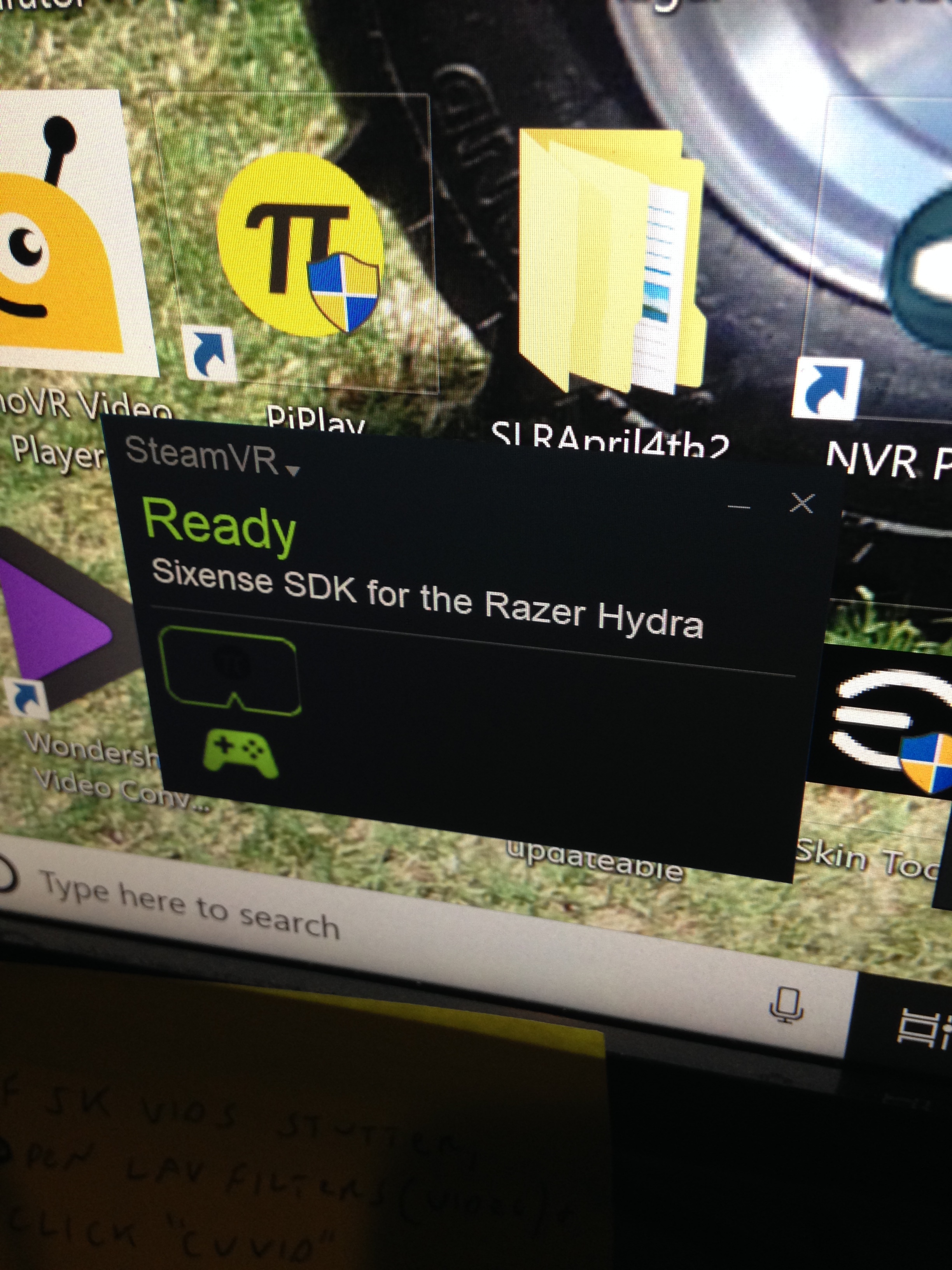

Ok, Thanks much Helio, I now have controllers for the first time in a year since I bought the P4K. Yes I see what you mean by the jutter. I have it too. Not a big deal though. One other question and it can wait but how do I keep my Hydra controllers from moving the curser on the desktop. Its keeps messing with the desktop during gameplay. thanks!
Hmm… Will have to retest on my end. You might need to disable the sisense driver you installed.

No problem. I dont have enough time with them to notice any drifting just yet. I played Space Pirate some. I disabled the Sexense before I installed the SteamVR drivers.
