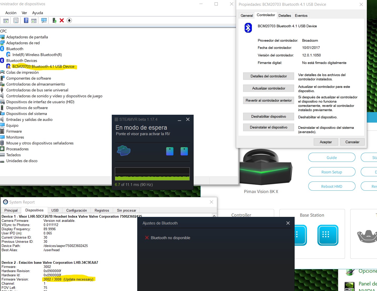

I’m giving it a lot of thought to be able to enable bluetooth in SteamVR to be able to update one of my Valve 2.0 base stations from the FW 3002 to the 3008 since the “standy” mode is much better than the previous “sleep” mode. I know that it is impossible unless you have connected an HMD of HTC VIVE with the linkbox or an Index that has the integrated bluetooth. I even bought a linkbox 2.0 to be able to have bluetooth enabled, but SteamVR still refuses to do it, since it does not detect a connected Vive PRO. So if that’s the reason, I have found a Vive PRO and Valve Index HMD emulator and it makes the system believe that your Pimax or other connected HMD is a Vive or Index. Now when I do a system report from SteamVR I get this:

So SteamVR is happy to have its HW connected, but the problem is that I no longer have the LinkBok 2.0, I returned it to Amazon.
I’m trying to install a USB bluetooth but the chip is not a Broadcom BCM20703, which is the one that SteamVR is looking for.

I have managed to install the SteamVR bluetooth drivers to my bluetooth usb, changing the VID and PID that the SteamVR drivers are looking for for my bluetooth VID and PID, you have to install them in “unsigned drivers” mode since I have modified the .inf of the drivers. Now in the device manager I already have the bluetooth “BCM20703 Bluetooth 4.1 USB device” with the SteamVR drives. But of course, they do not work since they are not actually compatible with my device, but SteamVR should complain about the bluetooth installation, however it keeps saying that bluetooth is not available. I think that what it looks for in the installed devices is its VID and PID of its Hardware, that is: “BCM20703 Bluetooth 4.1 USB Device (VID: 0BB4 PID: 0306)”, but it will not find it. I have even changed the VID and PID in Regedit but the HW identifier is impossible to change using SW modifying files. It is recorded in the eepom of the device. I have read a little about the possibility of reprogramming the bluetooth, I even have a suitable programmer that I use for the 3D printer. But my bluetooth usb or most of them are so small that you cannot disassemble them to solder the suitable pins and read or write in the memory of the chipset. And even if I could solder it and connect it, not if it would ever change the proper VID and PID. Or it would be useless.
If anyone has an idea how to trick SteamVR into using another VID and PID from the bluetooth installed with their drivers, maybe they could turn the functionality on.
