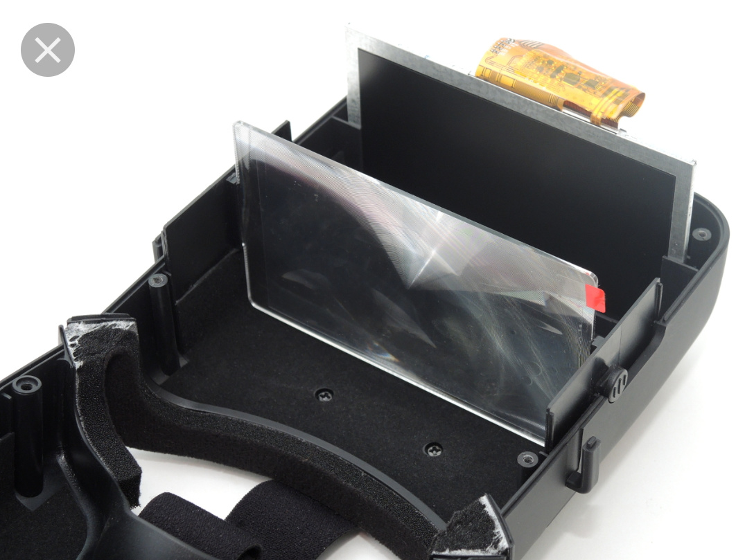

Yes fpv hmd (one display) + light-field technology (3d) or autostereoscopy.
A light field requires you to render more than two views per eye, (1 view for every angle of a 3D object) so think 8X the cost of current rendering to do that.

Light field have 1 render image on 2 display

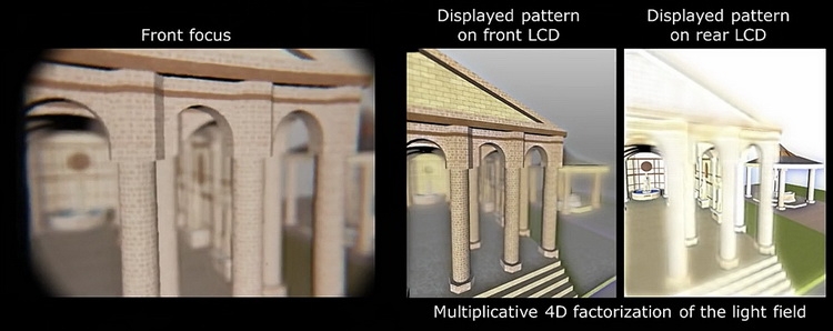

https://www.computationalimaging.org/publications/the-light-field-stereoscope/![Nvidia-NE-LFD-VR|690x274](upload://mbLoSjETY50AbRnvBZYuPpJs9Vf.jpeg)
I don’t think you watched this video. This is a light field stereoscope which uses two panels, and image synthesis to create the multiple views on the focal plane.
I’m suggesting something that is way less computationally intensive
