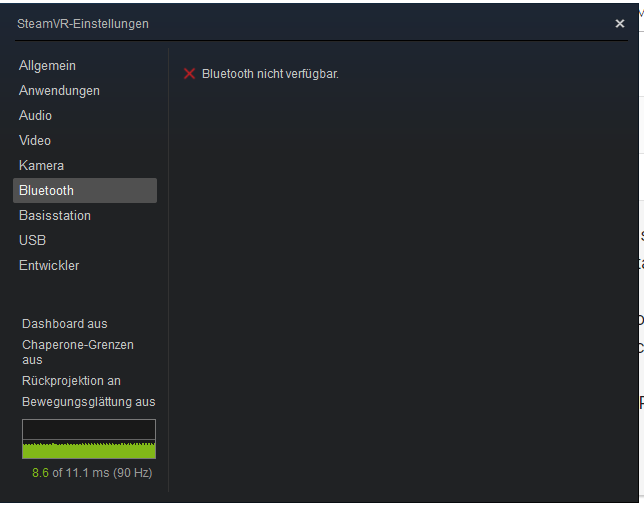

If I use the Pimax 5k Plus then Bluetooth is also off.
With 1.0 it was always on with 2.0 OFF!

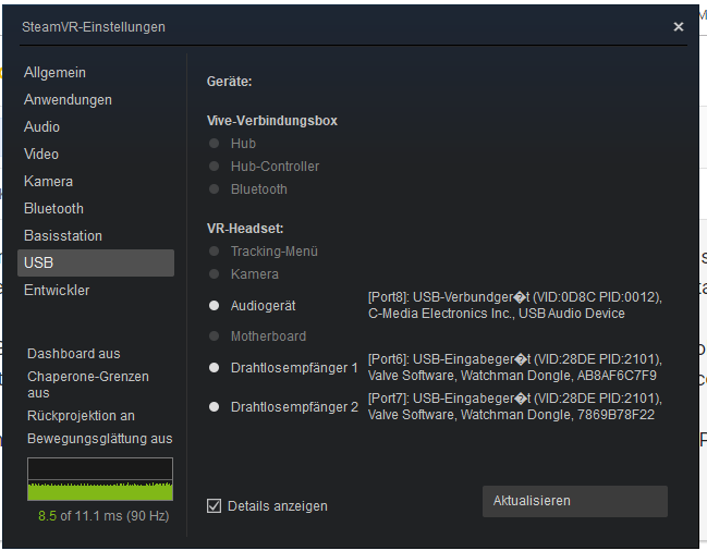

I am not sure, to which “tracking problems” you refer to. If you mean “power management” then it has nothing to do with tracking, and I never saw it working on anything but Vive headsets as it requires BT driver for the headset linkbox BT hardware. So I am surprised it worked for your P5k+.
Doesn’t it work if You leave the Vive link box connected? I think I’ve read that somewhere. I.e. the Bluetooth module is actually in the link box.
Good point. On HTC Vive it is. I just checked on mine, by disconnecting the headset, but leaving the linkbox connected.

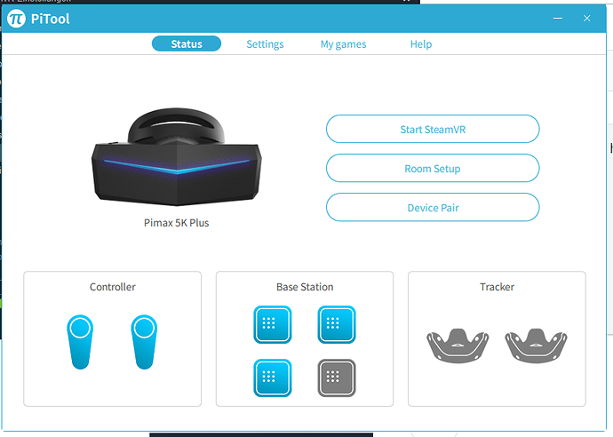

I seem to have found the tracking problem.

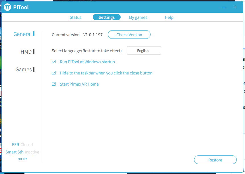

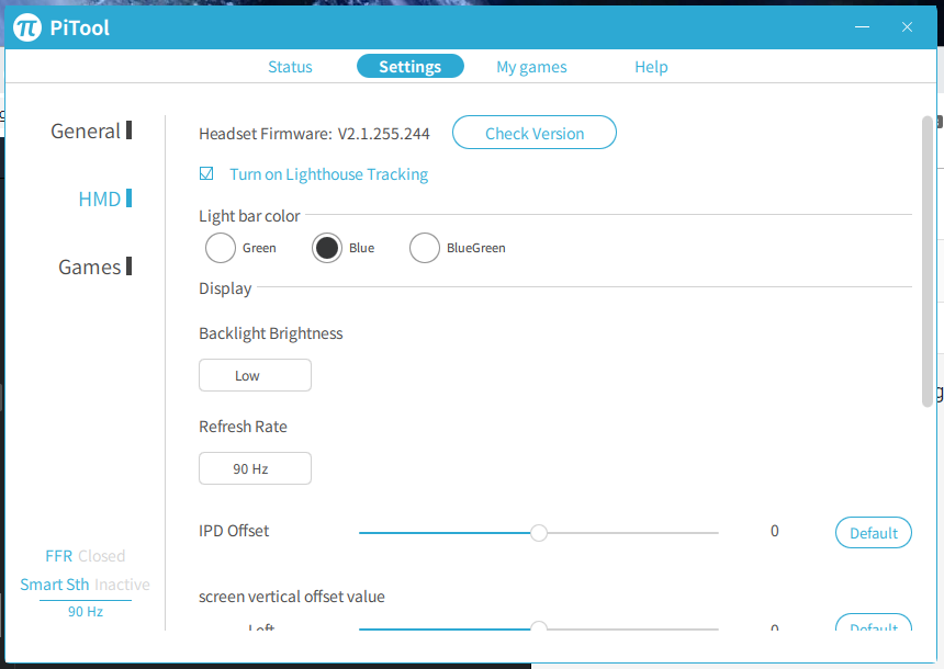

It was up to Pitool!
I use index controller along with three base station 2.0.
If I have tracking issues, I can not solve them until I restart Pitool.
I can play some time then. But after some time (1-2 hours) these problems come back.
I then have to quit all and restart the headset and Pitool.
There it goes again!
It must be a bug in Pitool.

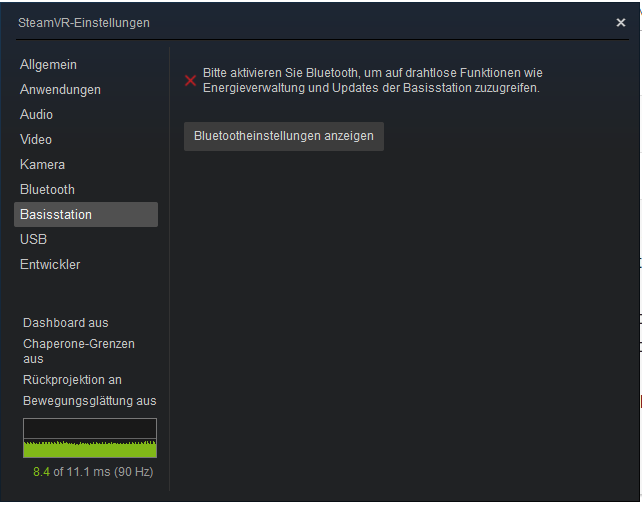

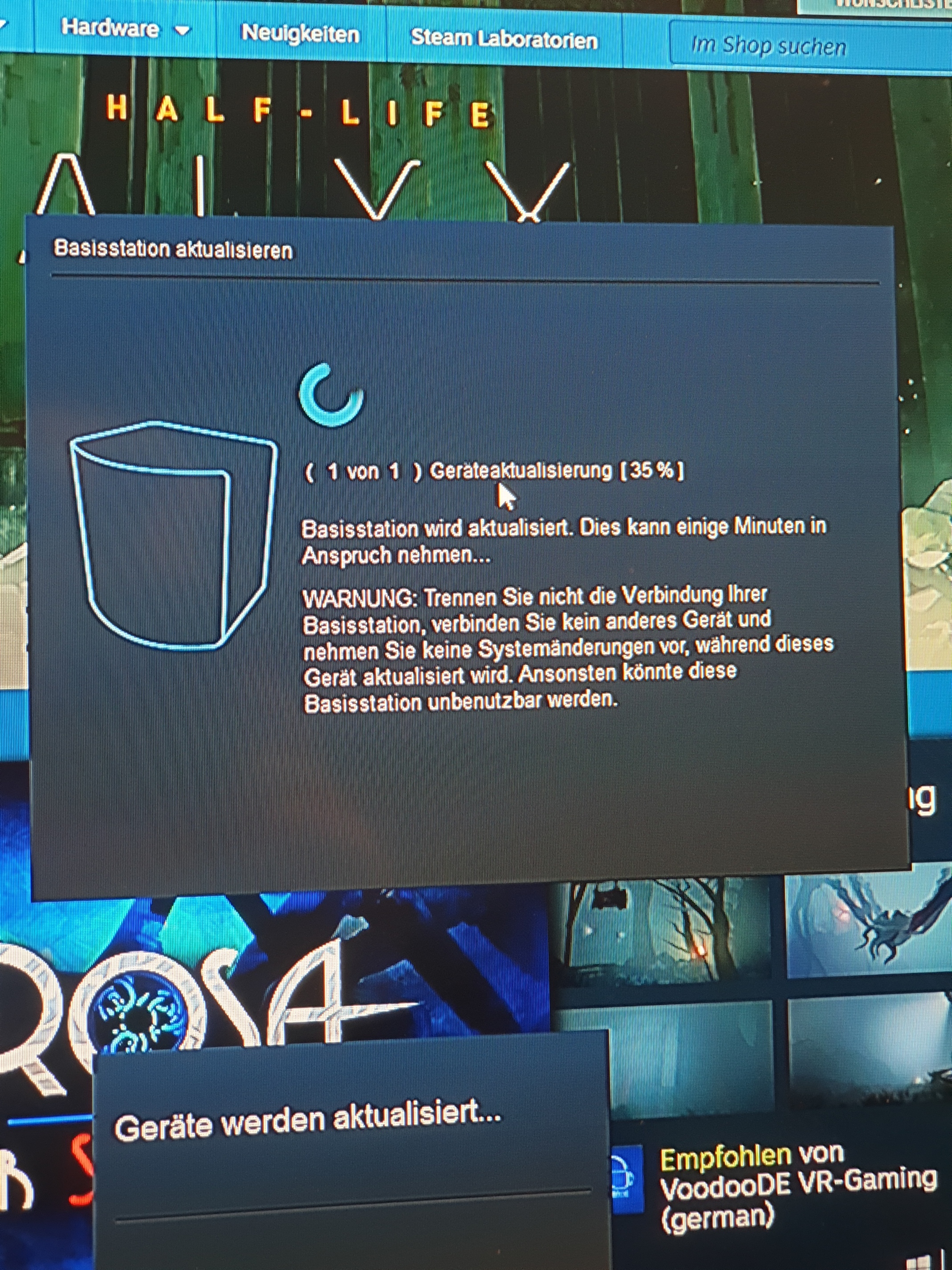

I found the problem.
It seems like the Base Station 2.0 does NOT do an automatic update when a Pimax is connected.
Only when I have a Vive index connected all Baste Station 2.0 have been updated.
I think the tracking problems are fixed!
Pimax should fix it!
The Base Station 2.0 needs an update, even if you only have a Pimax VR glasses!
@Matthew.Xu
Even if you have some other Bluetooth adapter (to take the place of the disconnected index), as part of your system?
If you don’t, there is no route of communication with the base stations, through which updates could be made – One should still be able to update them by connecting them by USB cable, to the computer.
