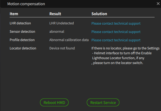

That last one is really confusing to me. there doesnt seem to be a “helmet interface” section in the settings and I have no idea what this lighthouse locator function is. It stopped working while I was using it, was very strange. Ive tried reinstalling pimax play, reseating all cables including the one in the headset itself, rebooting my PC, flashing new firmware, nothing seems to work. Diagnostics shows no issues whatsoever and I really dont know what to do. Ive tried contacting support but I cant seem to get through to anybody.

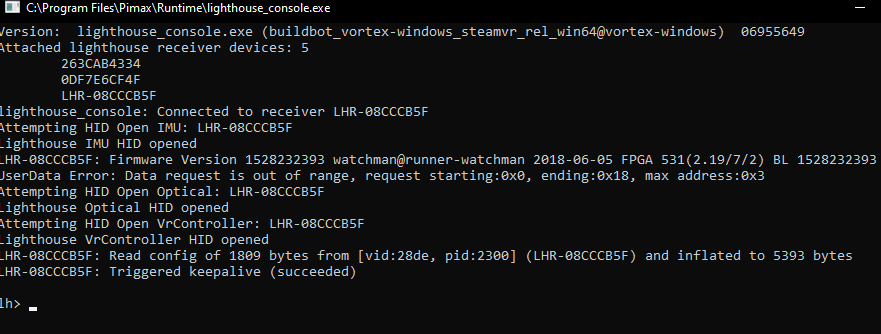

I do also get this error in the lighthouse console which MIGHT be relevant. “Userdata error”

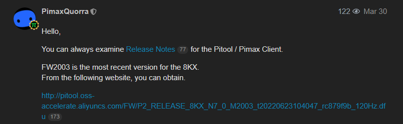

It appears that the wrong firmware was flashed, resulting in the headset being bricked. Please only flash firmware versions starting with “200*.” Avoid flashing any other firmware that starts with “M2**.”

This is the correct firmware.
Flashing the M299 firmware will result in bricking the headset.

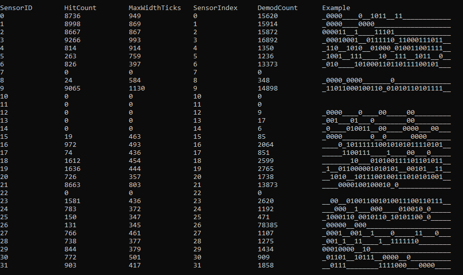

the sensorcheck command in lighthouse console shows some activity so… something is happening. its a bit over my head but the sensors on the headset are reporting something so thats… something. I also have this.
again, kinda above my knowledge here only one of the USB devices in the headset seem to be doing anything at all.
