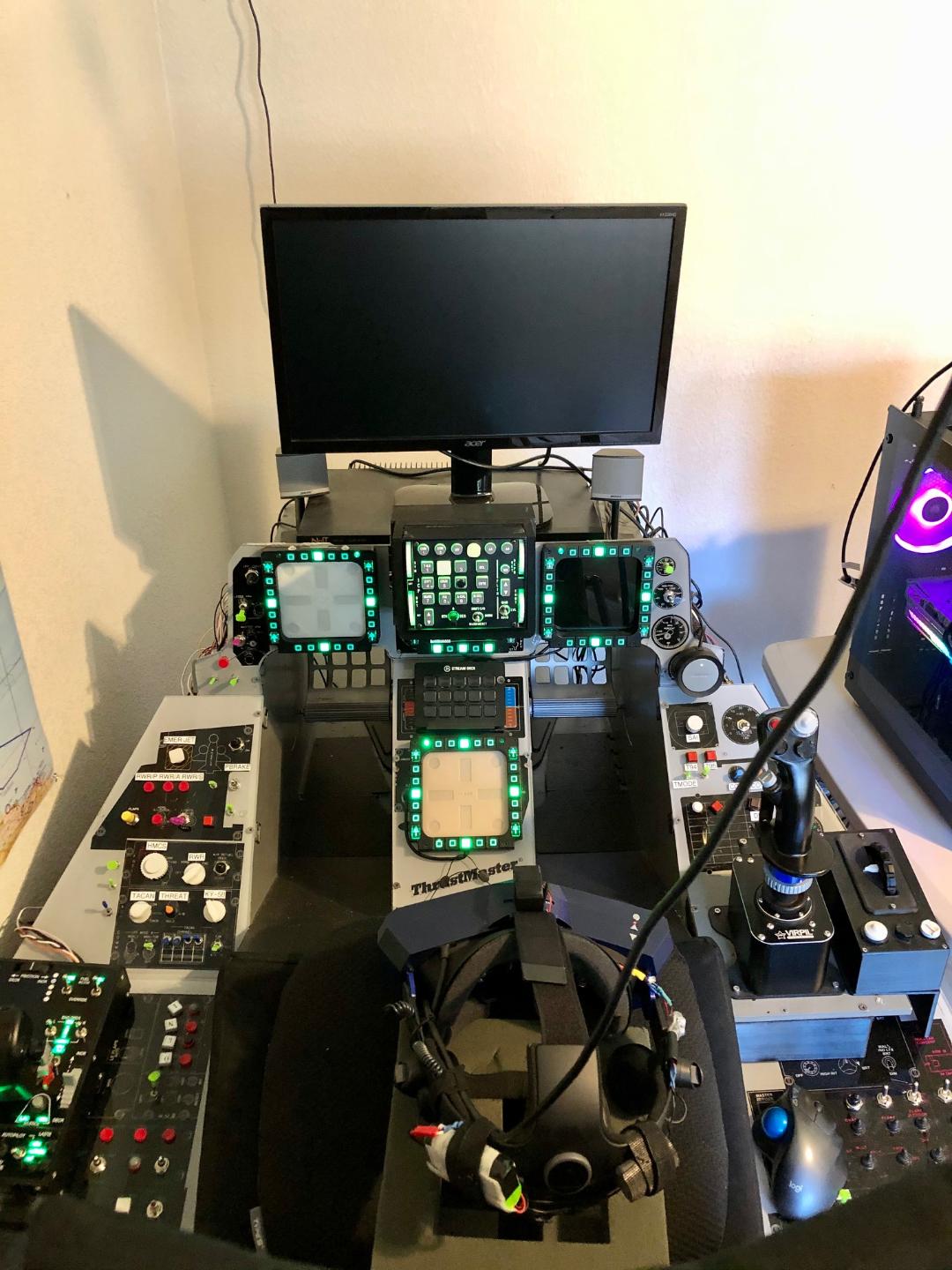

Well I am happy for this thread as I want to put a large TV on the wall in front of my simpit as I only use the monitor to be able to see the desk top to click on stuff like Discord or SRS stuff or to start DCS (or ED). The little monitor I have is a bit too small and was thinking a 1080 TV at about 60" or so would work well for that as most of the time my 8KX is on my head. I just do not want to take away any FPS!
I’m not an expert in this but I would say that if you stay with the 1080p, you should be fine. The 4k takes a bit more power.
(just to cover the basics, your computer couldn’t care less if your 1080p monitor is 18" or 80", it’s still pumping the same number of pixels (1920x1080) so there won’t be any performance difference.)
Having said that, I didn’t notice any difference in performance from adding that 4k, but the jury is still out. Meaning that I’m still monitoring things for any difference.
