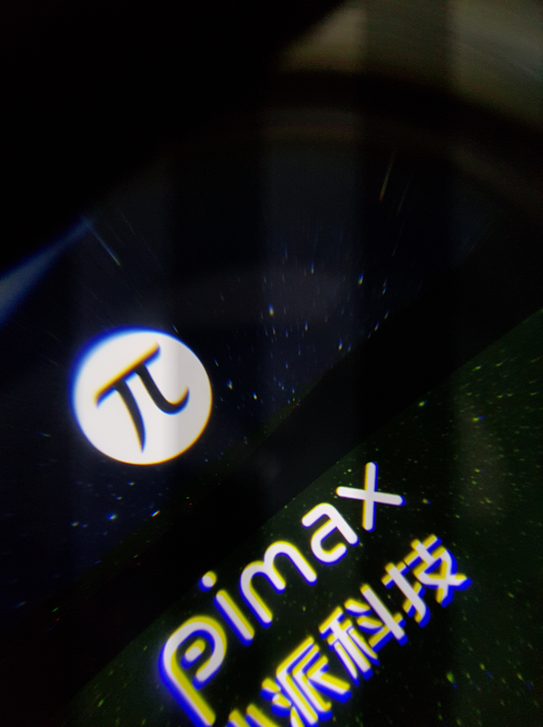

Just like the Pimax 4K, the default static Pimax image can be changed if desired, C:\Program Files\Pimax\Runtime\resource
Replace pimax_default.jpg with another 2560x1440.jpg (Preferably solid black).
Thanks for pointing out how to change the default image. With this method users could show an IPD adjustment image. I need to test if my 5K+ unit goes into standby mode after some time or not. Will report back.
Did the test. After six minutes of inactivity the panels show a uniform middle gray. It uses the image ‘bg.png’ from the runtime resource folder.
Edit: Ok, did the test again with .90 Pitool Version. The panels show black after less then a minute with a moving little color changing square. A tiny vibration is enough to show the actual content again.
