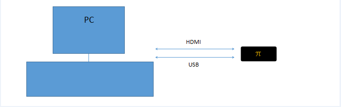

Picture 1. How does Pimax connect to computer
Pimax is connected to PC by USB and HDMI
