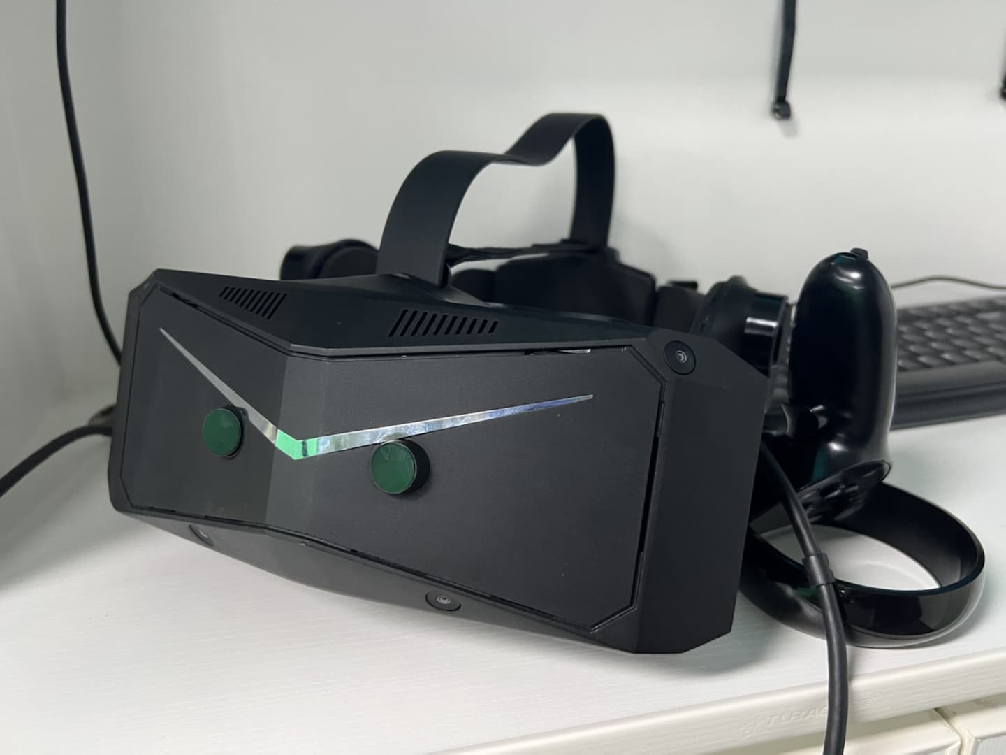

I hope this doesn’t mean “shiftall” for Pimax Crystal. :smiley:
Also my fav as second device
:angry: emoji
Interesting.
What are we looking at?
