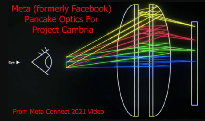

The Fresnel optics features a wide field of view compared to Pancake but is prone to chromatic aberrations (ghosting/overlapping colours). Furthermore, software calibration taking up processing power must account for Fresnel lens known as “distortion’.
Pancake, on the other hand, works by folding a series of lenses into a curved shape and bouncing light within the glass or plastic. This allows VR HMDs to be thinner and lighter, while also freeing up processing power due to the lack of distortion.
The Pancake lens design will bring on stylish design that attract a wider audience?
Compared to Fresnel lens, what’s the downside from Pancake optics?
What does it signal for the future of VR HMDs?
Kopin announced an all plastic Pancake lens design called P95, which specially optimized for use with 2.6K x 2.6K OLED high-brightness microdisplays.
Like augmented reality, VR is on a path to a slimmer and lighter future.
Is the pancake lens approach inherently incapable of or disadvantaged for wide FOV? Or is it merely that early incarnations of them have relatively narrow FOV?
Another thing I wonder about pancake lenses. If they have poor light transmittance, does that mean they heat up? The energy from the lost light has to be going somewhere. But maybe it’s not enough energy in total to matter.
Stems from Pancake’s boucing of light within lens itself, resulting in low light efficiency.
Problem of ghosting and is also a scourage for this lens.
Also,the cost of Pancake is nearly 10 times higher than that of Fresnel lens
Kopin says P95 has a field of view 95° diagonal – around 20% narrower than typical consumer VR today. :pleading_face:
