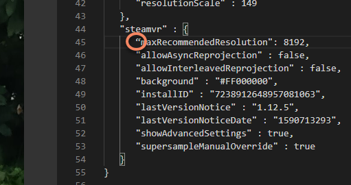

https://community.openmr.ai/t/default-vrsettings-maxrecommendedresolution-steamvr/21330/22?u=mreis
Like this one.
Its the max recommended resolution setting
Oh and take care of the " there are different ones and if you copy paste (look closley) they might be different then the ones that are already in the file - then copy paste the ones that where already in the file into place. In the pic, the red one is the “bad” one.

Yes is basically the same issue just more prominent for higher resolutions. The Config is always the same it will. Just allow steam VR to use higher resolutions then normal.
