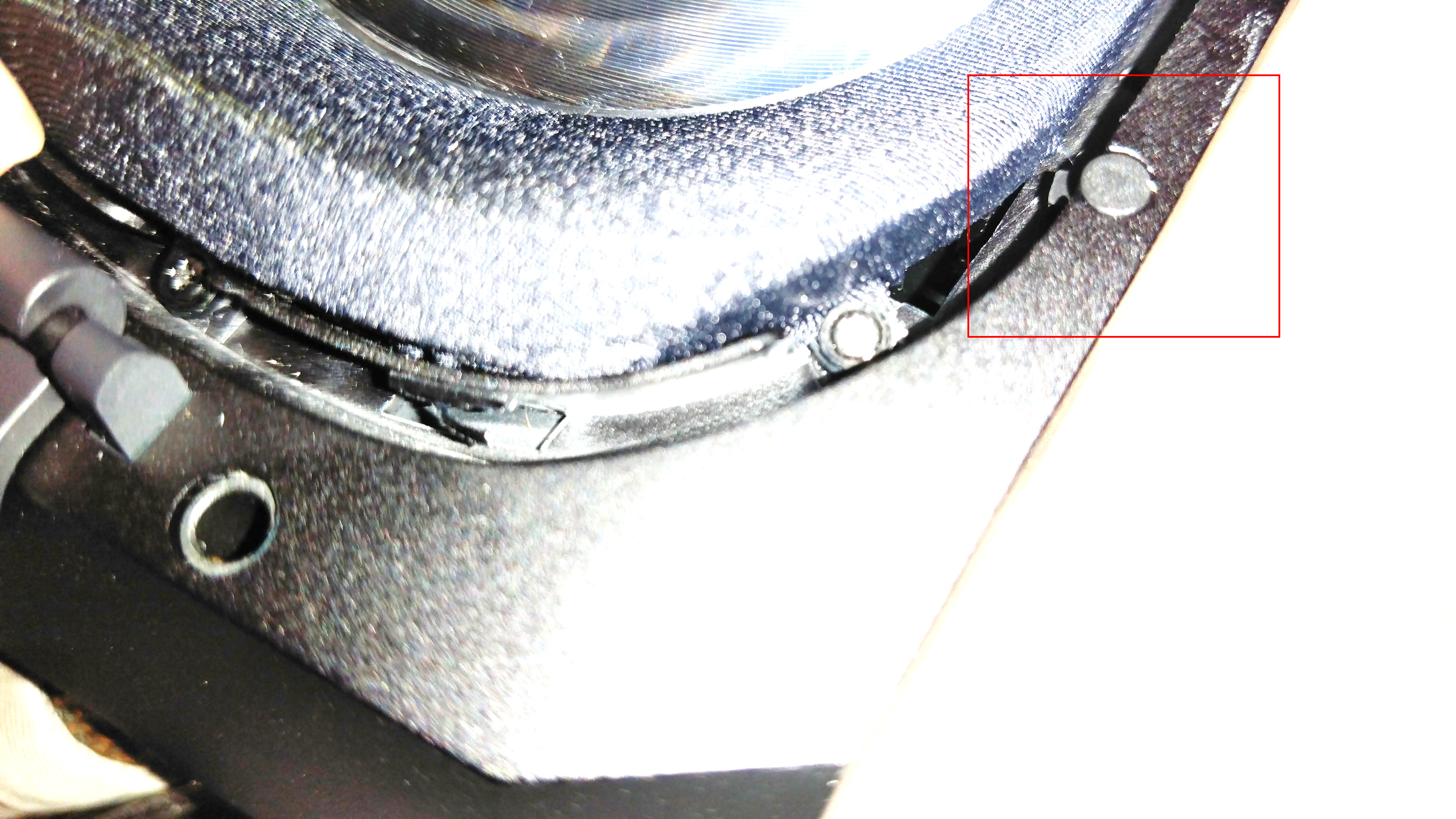

It seems Pimax has added some locks to the face mask that haven’t been in place on the Unit of @SweViver.
Now i don’t have my Pimax yet but by the look of it you have to turn them to the side to unlock the face mask.
At least that is what i get from the picture.
Edit: Here is the Unit from @SweViver clearly missing the locking bolts.
