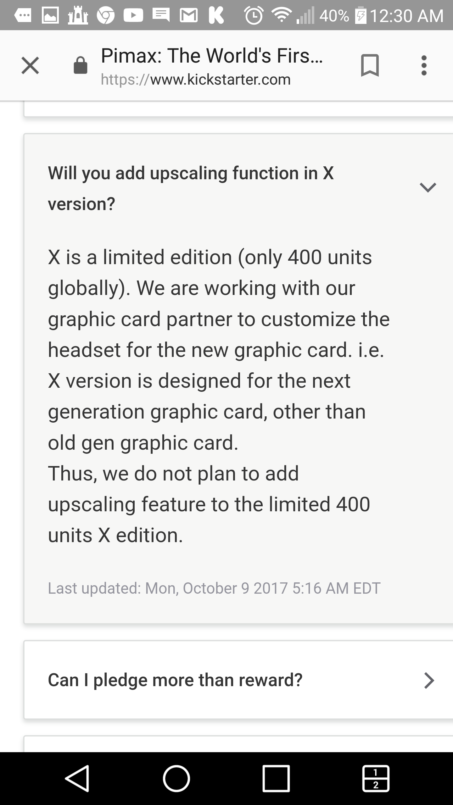

The above is on the Kickstarter Faq.
This was there from the beginning of the Kickstarter, right? In the responses to backers they still wrote some “maybes” though.

I got a confirmation by email from support that the 8k X will NOT support upscaling. I had asked whether to downgrade to 8k or not. I did downgrade my pledge after receiving that email. It might be possible to upgrade at a later date. there was some discussion about that previously in the forum.
