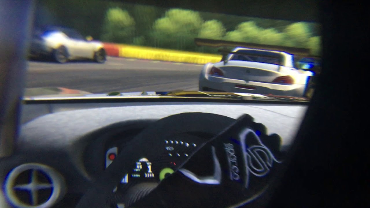

Because an image is worth a thousand words.
A video is worth a millions words.
Large-FOV is limited in render resolution by steamsettings, pls look here: https://community.openmr.ai/t/how-to-exceed-the-maximum-resolution-of-4096px-imposed-by-steamvr/16067
Yep but a lot of people was telling me here on the forum that it wasnt anymore necessary to do it because it was something old and not actual with latest pitool software. So I did a video to show they were wrong ( part 1 ) and the part 2 video show people how to do it right. The video clearly demonstrate the proof of that evidence.
Thanks. I had also heard that the setting was unnecessary. Clearly, your tests show that isn’t the case.
