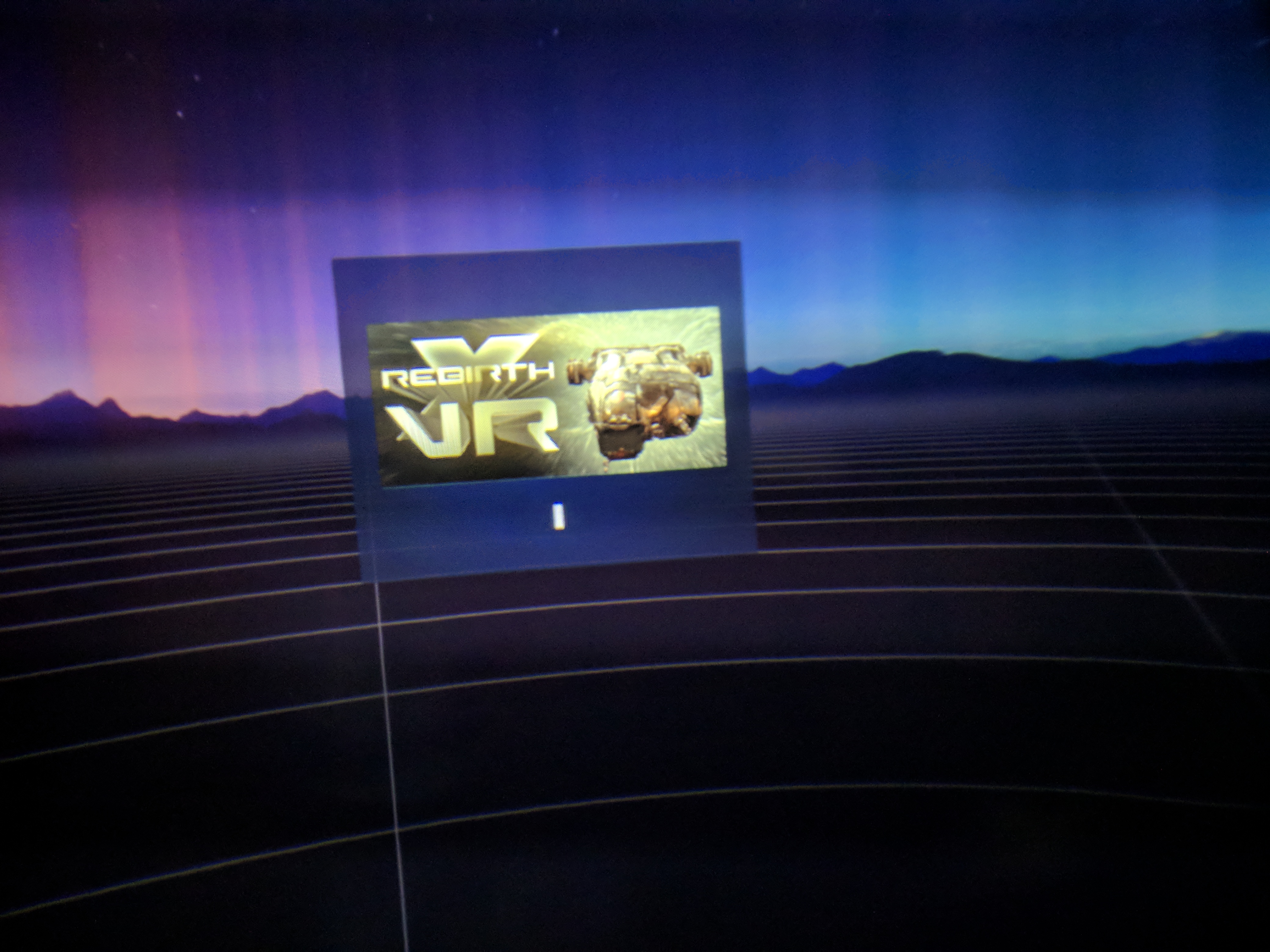

My pimax 8k has the same problem with X rebirth VR edition. Even with the latest pitool, graphic driver and Parallel projection enabled.
Yes, I also can not run X Rebirth VR, I see only this
but the game safely works on the monitor, but not in the helmet.
Can anyone find a solution?
Or do I have to return the money from Steam.
@park, help start the game, maybe there are ideas?
Everything, I found a way. Just write in the launch properties:
“-openvr_force_proximity” (without “”)
(It is described here: https://steamcommunity.com/app/570420/discussions/0/1471966894874925139/#c1471967615840265601)
Next, we need to enable “parallel projections” in PiTool and everything works fine on the Pimax 8K!
The “X Rebirth” looks amazing with Large FOV on the Pimax 8K, just great
