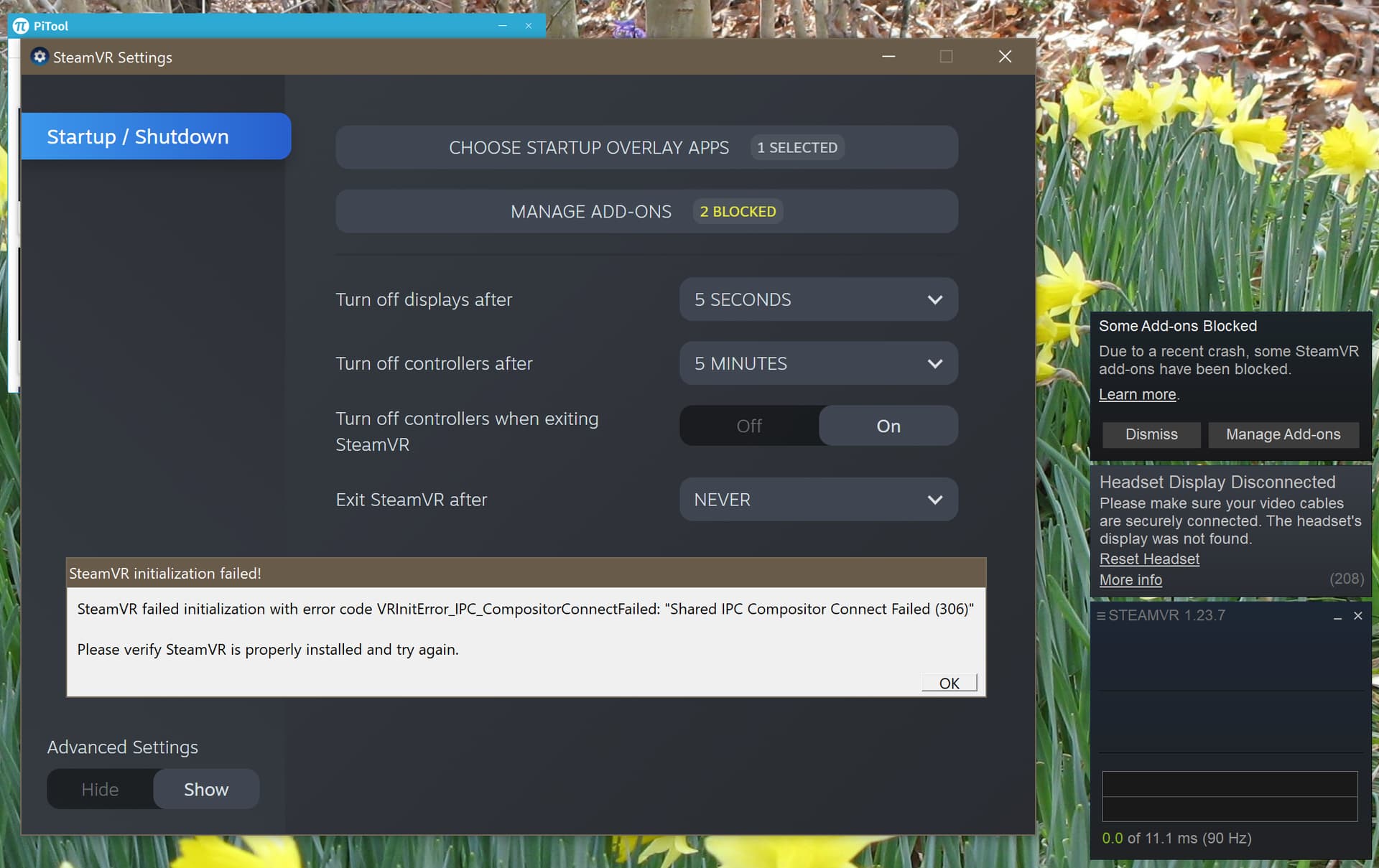

For the first time in months, I decided to try VR again. I was hoping things would be working better, but no, it’s worse. My 8KX is connected, I see the Pimax logo screen and hear sounds through the headset, but SteamVR always throws up various error messages (shown below) and makes me re-enable the hardware. In the past, if I re-enabled the hardware in SteamVR, exited but did not restart it and re-installed PiTools, SteamVR would start correctly ONE TIME (after that I needed to repeat those steps). This was a major pain, but tolerable (at least I could use VR). However, this no longer solves the problem. I did install the latest PiTool, but I’m wondering if that was a mistake.

Any suggestions? @hammerhead_gal
Click ‘manage add ons’ in the pop up in steam on the right hand side of your screen. Most likely the pimax software has been blocked, so unblock it and restart steam VR and you should be good to go.
I recommend to use PiTool 1.0.1.277, stable for me with 8KX (type version 2075) with FW 2.1.255.299, If it runs without a flaw, then try newer PiTool version.
Thanks, but that’s not enough. I already do that as part of my routine, “I re-enabled the hardware in SteamVR”.

After another 30 minutes of googling and testing, I was able to run MS Flight Sim (for about 45 min, then it crashed).
Solution: Either or both of these (I did them both together, but didn’t test singly): Run Steam (not SteamVR) as administrator and lower the Pimax framerate from 90 to 75 Hz.
I also noticed that I could fix the horrible stuttering in VR, by making sure the active desktop app in Windows was not MS FS.
